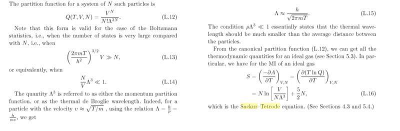

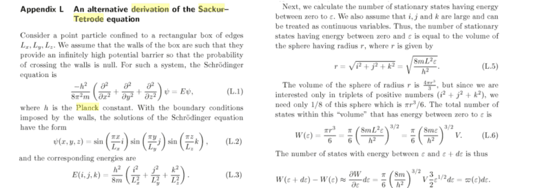

Why do they introduce the partition function. I have seen it in the derivation of the Boltzmann distribution. But I don't know the physical significance of it here? And how do they get to (L.11) after that? I get everything until L.7. Including L.7.

I get: ##Q=\frac{V}{\Lambda ^3}## Here we have used the integral ##\int_\infty^0 \varpi e^{-\beta \varepsilon} d \varepsilon##

They use later in (L.16) in the first post that
that ##-\frac{\partial}{\partial T}(\frac{1}{\beta}lnQ)=\frac{\partial A}{\partial T}##
But here they use Q and not ##\Omega_2(E_0-E_r)## that I have derived this relation for Helmholtz's energy. Can someone derive why ##-\frac{\partial}{\partial T}(\frac{1}{\beta}lnQ)=A## as Q is the integral over all the different ##\Omega_2(E_0-E_r)##.?
The only difference between what's written in my previous posting and this writeup is that they call the Helmholtz free energy ##A## instead of ##F##. I've also derived that ##A=-T \ln Z## (I call it ##F## instead of ##A##; sorry if that causes the confusion).
