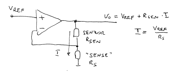

I have 4 resistive sensors thus I need to tie 4 floating current sources. Floating current source will give me output voltage linear to the resistance of a sensor. I know it is not the best solution but it is good enough.
Image provided:
Hand-drawn schematic of a floating current source: an op-amp with V_REF on its non-inverting input, output driving a sensor resistor R_SEN and sense resistor R_S to a floating node, current I, and V_O = V_REF + R_SEN·I with I = V_REF/R_S.
None
I did it by aligning them one under another and tying Vref into one point but I am confused by the fact there is no ground.
Circuit schematic of four identical op-amp stages stacked vertically, each with its non-inverting input tied to a common VREF rail on the left, output feeding a resistor to a load to ground, and a feedback path to the inverting input.

akaliuseheal said:
there is no ground
What is the little horizontal line at the bottom end of Rs ?
