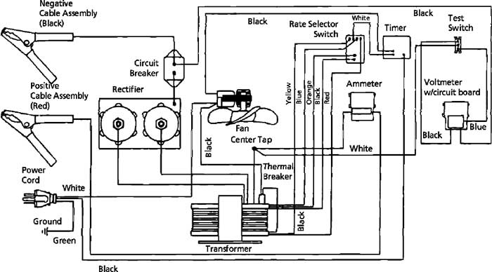

I am not even sure myself I will have to take front cover off. I do know there are three diodes on each side all six are connected to negative output and each pair of three's is connected to a 9 gauge wire this seems like there are two secondary windings. I thought it is half wave. It has 6, 8 and 12 volt output but not sure how this is obtained. It is not like alternator where three diodes are used for positive and three for negative. I think the picture I found of a battery charger looks like mine except where they use two diodes mine has 3 on each line off the tranformer. Seems like you could put twenty 10 amp schotty diodes and have the same thing?
  • Wiring schematic of a battery charger with a transformer, two rectifier blocks, circuit breaker, thermal breaker, rate selector switch, timer, ammeter, voltmeter and test switch, with black, white, red, yellow, orange, blue and green wires.

The circuit attached to Post #5 shows a centre-tapped transformer using two diodes as a full-wave rectifier. The diodes are not in parallel. Current does not flow in the two diodes at the same time.
