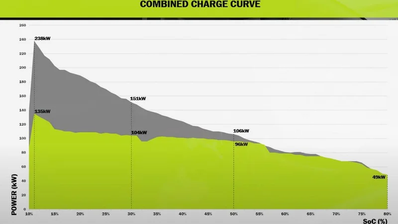

PS… It isn’t necessary to fully charge the battery each time. As seen above, with the battery pre-warmed, two separate 15 minute charging sessions with driving in between provides more energy and range than a single 30 minute session.
*EDIT: When I initially viewed this chart I thought it showed pre-warmed vs not prewarmed, but I believe this chart only shows the battery with initial cell temp close to 40C, the solid line is the cell temps and the dashed line is the power into the pack. What isn’t shown by this graph is if the cells are in freezing temperatures, this initial charging power will be much lower.

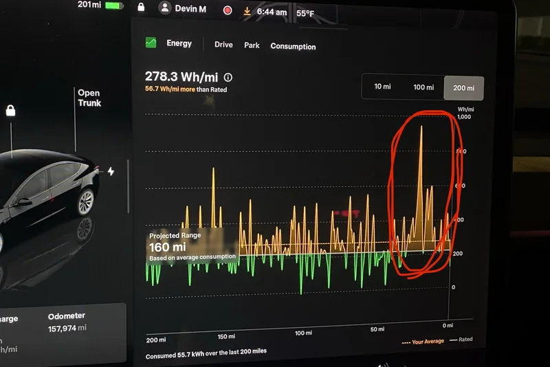

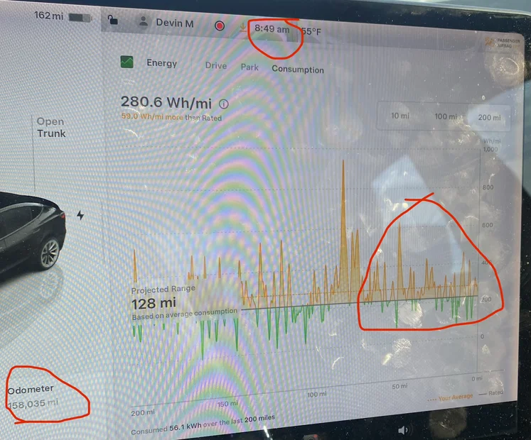

I took some measurements today. The temp was constant 55f. A full preconditioning took 3.3kWh. Then after 2 hours of driving and 61 miles traveled, maintaining the constant preconditioning took a further 1.3kWh. In the pictures below, the preconditioning energy use is shown in miles. These miles can be multiplied by the rated 222Wh/mi to get the Wh used.

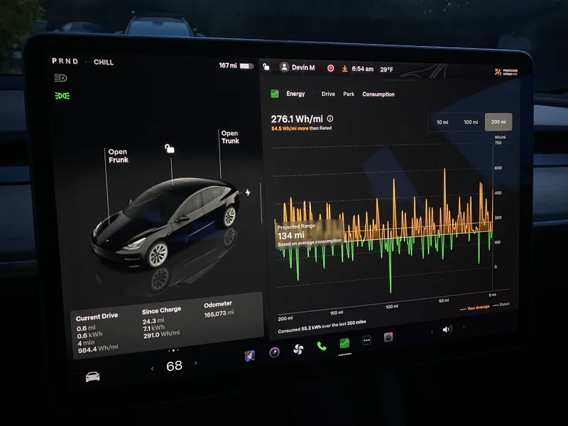

I started preconditioning the battery in the morning when the outside and car were approximately 29F. Battery state of charge 167mi remaining (37074Wh).
After 1hr 53min of driving while preconditioning (50 actual miles driven) and 75mi remaining state of charge the battery conditioning use was 31.6 miles equivalent or 7015 watt hours when I reached the charging station.

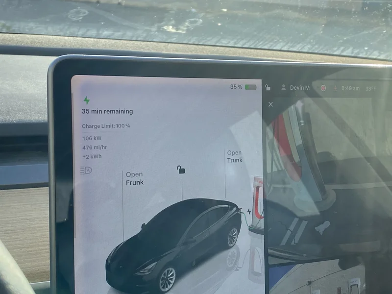

Initial charging rate was 106kW at 8:49am…
Charging was terminated at 9:03am after adding 108mi range (24976W/h) total 14 mins…

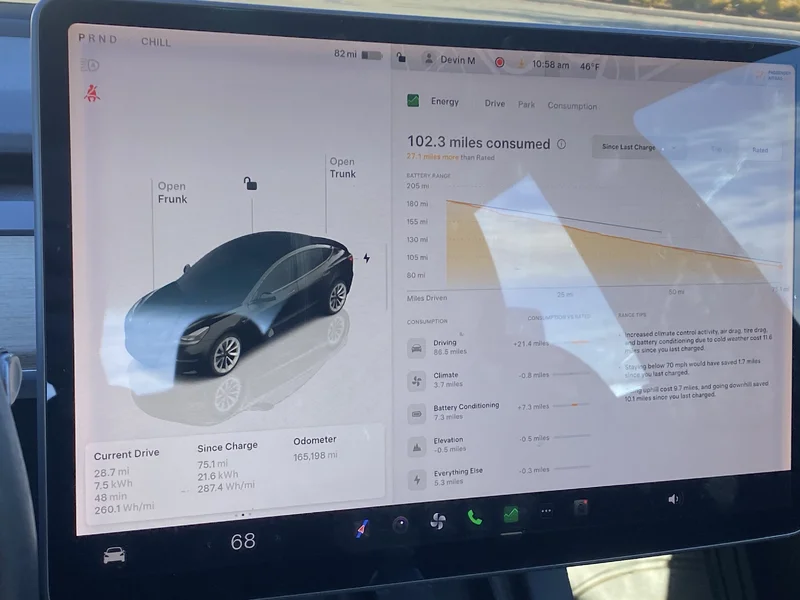

At 10:58am, after 1hr and 55mins of driving after the previous charge, maintaining precondition temperature for the entire time took 7.3mi range equivalent or 1620Wh…

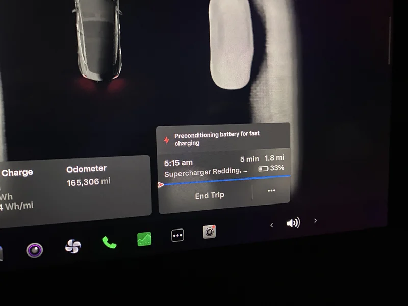

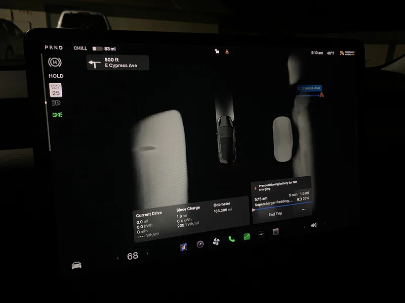

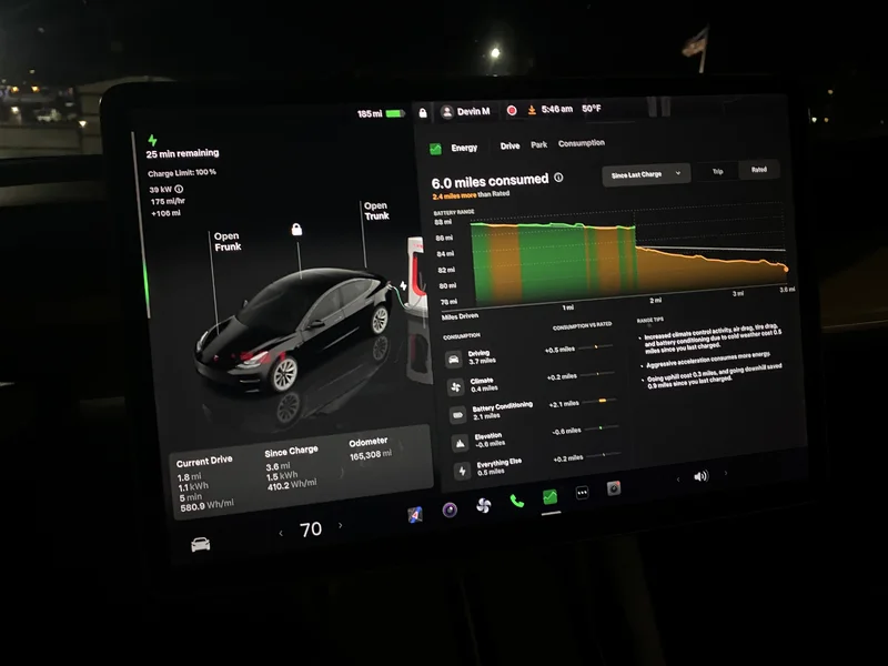

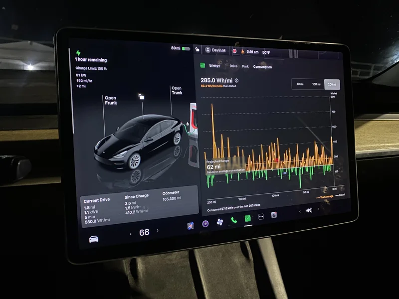

The following morning it was 49F and the battery had 83 miles (18426Wh) remaining. The charging station was 5 minutes away. I planned to measure how long it took to add 100 miles (22200Wh) of range while only preconditioning the battery for the 5 minutes it took to reach the charging station. This 5 minutes of battery conditioning consumed 1.9 miles (421Wh) of effective range.
Charging commenced at 5:16am and finished at 5:46am taking 30 minutes to add about 100 miles (22200Wh) of effective range (as opposed to 14 minutes the previous day).
