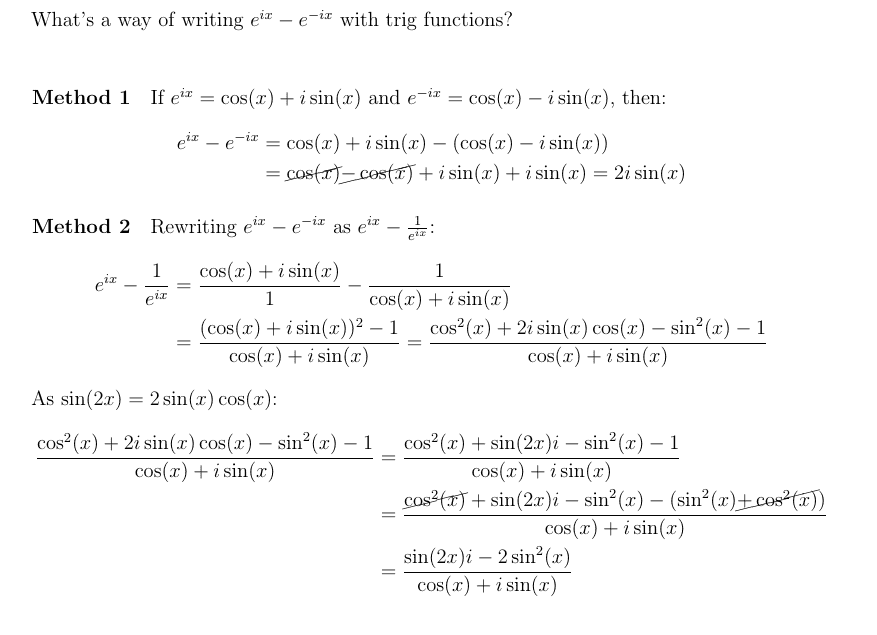

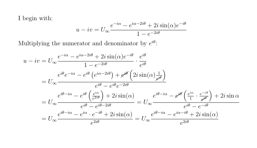

This is just not making any sense, sorry. I'll put all the steps I've done below.
I feel like I'm just going in circles. And then for:
haruspex said:
What's a way of writing ##e^{ix}-e^{-ix}## with trig functions?
Can you see how to get the ##e^{i\theta-i\alpha}## and the one like it into the same form?
Depending on which way I do it, I get different answers... which is weird! I don't get it.
Yeah, I don't know anymore, nothing is working
In your first block above, I do not understand how in the denominator you convert ##e^{i\theta}-e^{-i\theta}## to ##e^{2i\theta}##.
In your attempt to convert it to a trig function instead, second block, both attempts are correct. The final forms you have are equivalent, but using 2 sin x cos x = sin(2x) in the second attempt was not helpful. Use the result from the first attempt to replace ##e^{i\theta}-e^{-i\theta}## in the denominator.
The first two terms in the numerator form a pair of exactly the same pattern. Can you see that? So you can use the corresponding trig substitution.
Ohh, I see it, I see it. What a silly mistake, I can't just add them. Alright, I'll give it another go. Thank you

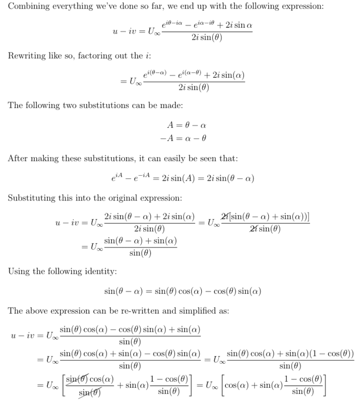

Okay, I think I was able to do it. For the sake of completion, I'll put the rest of my solution here.
I realize the substitution probably wasn't necessary, but I found it easier to do thinking about it that way.
Thank you very much everyone for all your help :)
Well done
