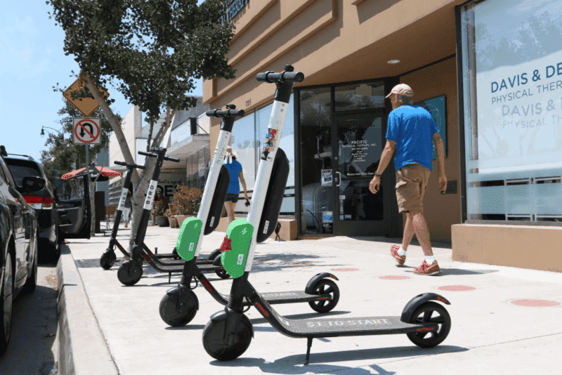

I've stayed away from this thread because it is frustrating for me from an engineering perspective, but Prathyush could you please compare and contrast your proposal with the new public electric scooter paradigm? You seem to be wanting to propose a new individual transportation paradigm, and this new one would seem to satisfy what you want to do?
https://www.dailybreeze.com/2018/08...munities-and-rev-up-turmoil-for-some-leaders/

Honestly electric scooters are pretty good. They have an extremely low foot print per person.
The drawbacks are you can't sit. They can't travel at 60m/s. They have a very low range. They are constantly at risk of colliding with something or someone.
Add dedicated set of interconnected highways for these scooters to move seamlessly. Add some sensors to detect other scooters, and integrate it with maps for automated driving. Batteries are expensive, might as well put them on a maglev track for power delivery.(and you can remove the motor) Finally add a chair, and you basically have the system I am proposing. It's the limit where everything becomes as lightweight as practical.
A computer controlled Aerodynamic chair on a maglev track is basically the proposal, It's enough to cover a very large pc of traffic use cases.

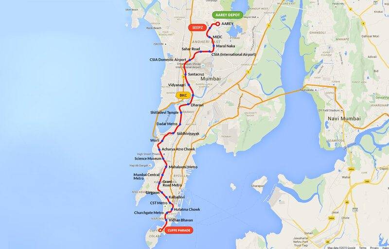

Couple of general points about a realistic city like Mumbai.
1) Mumbai is a linear city in the dense areas.(map enclosed). Local trains operate at a max speed of ~80 KM per hour. Curvature of tracks should be more than 3.6 KM to operate the pods at 100K per hour at 60m/s. ( I don't think Mumbai lines so straight). At a speed of 20 m/s your throughput will be about 30000 - 35000 pods per line. (pods are arranged into trains separated by a safe breaking distance)
When you are comparing throughput numbers it should be noted that systems achieving 100K passengers per hour, people are pack more than 5+ people/m^2. Personalized pods are an order of magnitude more comfortable. If you consider seated local trains your throughput is significantly lower.
2) In the system I am proposing you won't run every line at 100 K passengers per hour. It's similar to high speed highways and ordinary roads. You have slower lines connecting into faster ones. And if you are approaching 100K/hr you would add more redundancy into the system and lower the throughput. One advantage of light weight design is lines can be vertically stacked. It also has a small volumetric footprint for tunnels (can be designed fit in a 2 m dia).
4) Designing a system for a city like Mumbai needs one central line through the heart of city. Possibly connecting all the way to a neighboring city called Pune towards which there is a lot of traffic. We are looking at around 150 KM of central track with lots of population centers along the way to split into. This is very high throughput line and you stack multiple lines into a fortified central line, with well designed ventilation and safety and something that can survive atleast and an RPG attack. Safety has a heavy price tag for sure.
You can also imagine different designs with low throughput dense lines and high throughput lines.

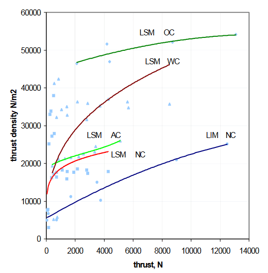

If maglev is going to be the future, we would have to re-imagine everything. Compatibility is just a transition issue. Average life of cars is some 12 years apparently. Given all combustion cars will soon be phased out in decades might as well rework the entire thing.I am trying to understand physics of maglev better. 10-20 Kilo N/m^2 is typical thrust density maglev designs can provide. If you don't use superconductors, magnetic field in order of 1 - 2 tesla limits the kind of engineering you can do. It is limited by magnetic flux of Neodymium magnets, and saturation of magnetically permeable material.( Neodymium is probably going to be the largest expense for the system)
10 KN is 1000 KG's accelerating at 1g.( Not sure what the deceleration thrust is, I don't think it is higher)
(attached graph taken from Linear Synchronous Motors:Transportation and Automation Systems)
