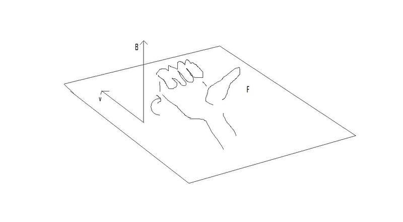

Ok... so I know the direction of the force is east, the direction of the velocity is north, and the Magnetic field is out of the page. So I am trying to determine what charge this particle is. The answer is positive but I don't see how that's the answer. Look through my work please, to see what's wrong.
My work...
My fingers point to the velocity which is north, and I curl into the B-Field, the direction of my thumb, which is out. The Force is still out not east unless I twist my thumb to the east. Then I see the force going to the east.
How did you curl your fingers towards your thumb?! Your palm should be facing up when you curl your fingers up.

Well what I did was I just basically I curled it counterclockwise into my thumb. That's why I don see the force pointing to the east.
dx said:
Your thumb should be pointing away from your hand, and should be in the plane of your palm.

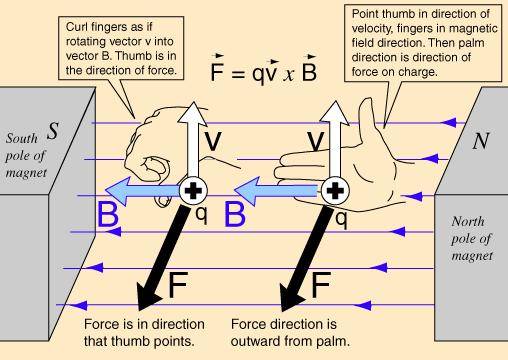

Exactly but I still don't get it. I am doing this rule: "You can determine the direction of the magnetic force vector by using the right-hand rule as follows: point the fingers of your right hand in the direction of the velocity vector and then curl them around to point in the direction of the magnetic field vector. The direction in which your thumb points gives you the direction of the magnetic force vector."
So I have this...lol...I know this a corny explanation...
Diagram of the right-hand rule for force on a moving charge in a magnetic field: velocity v points up, B points left between S and N poles, and force F points outward from the palm, down and to the left.
Using the First Image Rule:
So the thumb points out and the velocity points north. So I curled my fingers into my thumb and my thumb doesn't move east.
See attachment.
