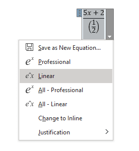

Is there some View that I can turn on so I can see the breaks in my equations in Word? When I use the standard View and try to edit/add to my equations, all of the breaks seem messed up. I try to backspace into some part of my equation to do something that seems intuitive to me, and the whole formatting gets messed up.

And then realize that I want to change the fraction formatting because it didn't come out right. But when I try clicking into the equation and use backspaces or whatever to try to fix the formatting, it gets all messed up and I can't seem to click in the right places to be able to make the changes I want.

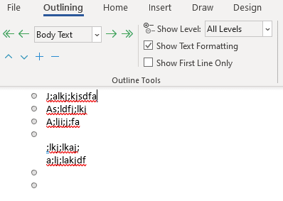

Like in Word there is a View called "Outlining" where you can see the special characters like carraige returns, tabs, and other hidden formatting characters. It is useful when trying to fix an error with Headline levels or Numbering, for example. I was just wondering if there were something similar for Word equations.

I think you'll be interested in this ;)
The little triangle on the right side you can switch it between Linear and Professional

You are saying that when you convert it to linear that it doesn't come out right?

Your co-author may be a long-time Word user, but he's evidently not familiar with the Equation editior, which I believe is relatively new (i.e. within the past 5 to 8 years). If an "equation" isn't coming out correctly, the easiest way to fix it is to go into Linear mode, as shown in the screen shots that @Joshy provided. There you can make sure that the braces are in the right places.
