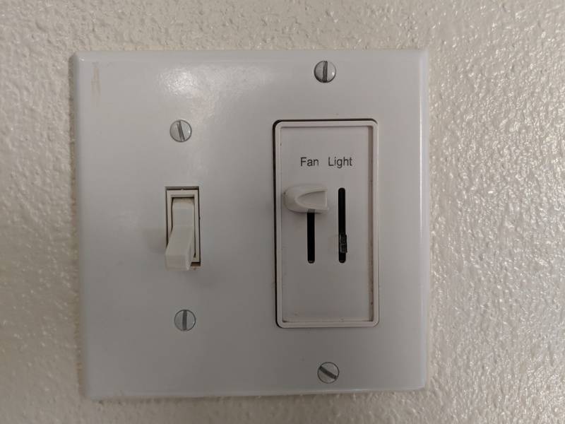

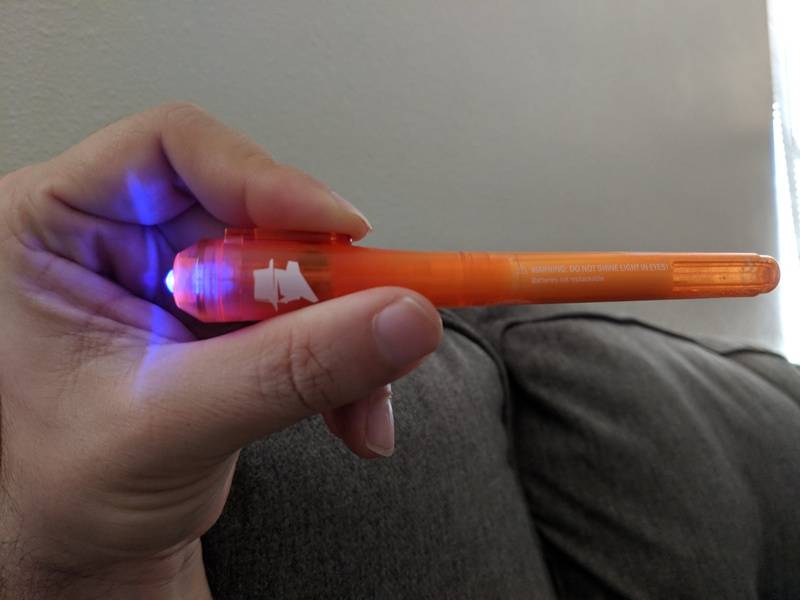

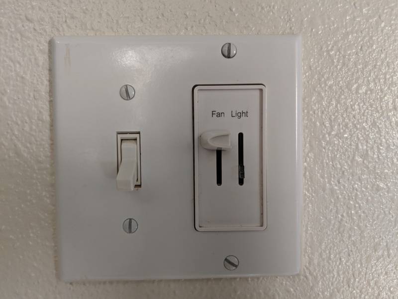

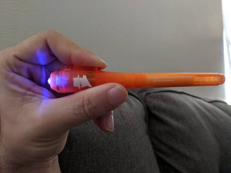

Hi, so I was hoping to get an EE's explanation for what just happened. So my son was apparently over by the light switch pointing a UV pen light at the switch. Suddenly there was very loud, gunshot-like pop, sparks flew, and I had to go reset the breaker.
Maybe correlation doesn't imply causation, but this was freaking weird.
This is the switch. He had it pointing at the switches on the right.
And this is the pen.
Any explanations?

Can you post the model number of the UV penlight? A datasheet would be even better, but any info would be helpful so we can look up its specs. Do you know what its claimed output power is?

Yeah, it's manufactured by Scholastic with the model number 556156 06/17. I tried googling it with no luck.

The speculations offered so far are very unlikely.
The image shown in the first post doesn't show an outlet--it shows switches which operate a fan and light. If a closure of those circuits occurs there wouldn't be a short that would trip a breaker; there would simply be a fan or light turned on. If the devices in the box are wired in accordance with the NEC, the hot and neutral wouldn't be anywhere near close enough for a short across them without probing through an opening with a metal probe even more capable than the one that Underwriter Labs uses to test these things.
Also, the long wave ultraviolet produced by the near visible led in that pen can't ionize air anyway, and that pen probably emits a few tens of milliwatts of UV, hardly enough to heat metal significantly.
It's hard to see how low-power long wave UV light could cause anything like what is described. The explanation must lie elsewhere.

Sparks indicate a connection between 'hot' and either 'neutral' or 'ground'.
Hot is black , neutral is white, green or bare is ground. If it's a metal box that too is grounded.
In photo, top cover plate mounting screw is loose and right dimmer handle is missing. Suggests amateur installation.
I always align the mounting screw slots vertical to give a neat appearance, yours are helter-skelter.
I suspect wires behind the switch are in too close proximity .
My advice is
Open the breaker , remove cover plate (carefully) and look. Should be smoke residue wherever was the origin of your sparks.
My suspicion is you'll find the dimmer mounting screws are loose and it can be moved enough to make some wires back there touch one another.
Get a handyman neighbor to help if you're uncomfortable .
Repeat - Open the breaker first.

I don't see any comment that the "switches" on the right side are variable controls and not off-on switches.
Post #17 by Jim Hardy: "In photo, top cover plate mounting screw is loose and right dimmer handle is missing."
So what? Those dimmer sliders are normally fitted with a piece of cardboard behind the plate. I still don't see a path for UV light to shine on the electrical contacts. If there was such a path, the contacts should be visible in the picture.
They're dimmers. It might look it in the photo, but the screw isn't lose. And yeah, that handle kept popping off and ended up getting lost at some point. It's just a plastic cap, the switch still works.

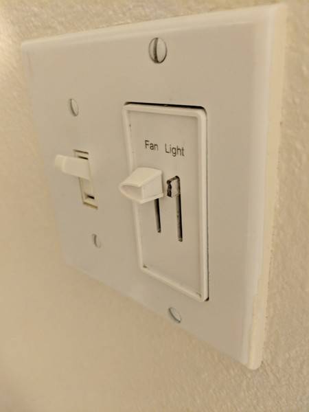

Here it is from a different angle.

No, he's positive he didn't come into contact with the plate. He was just shining the light in there.
NascentOxygen said:
It is an interesting occurrence. Was the ON-OFF switch in the ON position at the time? Can we take it that the sparks emerged from one particular slot under the Fan Light controls, is that definite? Was there soot or residue on the switch cover after the blast, but it is not visible in the photo because it has been cleaned away? Is your son of an age where he may have been probing with a short length of metal, such as a paper clip, and not wish to disclose this to you?
No, I'm positive he wasn't poking at it. I was in the room when it happened. The switches were in the exact positions shown in the first photo. For the slider switches, you slide them up for increased intensity.
Also, the slider switches are different. The fan one mechanically clicks at four separate stops, the light one does not.
I'd remove the plate and have a look inside, but I'm still recovering from hip surgery at the moment and don't want to mess with electronics right now :wink:
