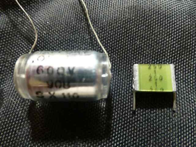

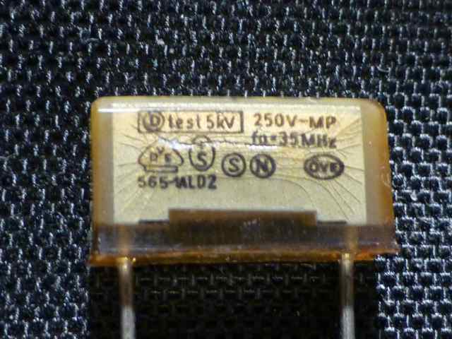

According to google results this dimmer has a fairly closed chasing, so whatever it was, it was within. Unfortunately, I could not find any picture about the inside of this unit.
Based on the usual circuitry of such dimmers, any mishap within the Si part of the circuitry would result just a full speed operation.
Therefore, my bet lies on the cheap foil cap of the filter circuitry. This cap (and an 1-2W resistor in series, which is a good source for dramatic sparks) usually bridging the triac.
And cheap foil caps are transparent...
  • #45

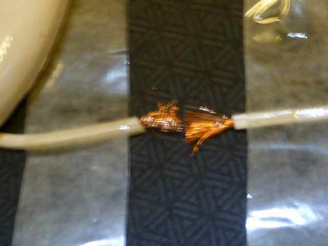

I decided to perform an experiment. I cut off a line cord from an old expired appliance and connected to a porcelain light bulb socket. I cut the line cord near the light bulb and exposed half an inch of the stranded conductor on either side of the cut. I splayed out the strands of copper and taped down the cord ends with the splayed ends very close together. The ends of the strands have somewhat sharp ends from the cutting process and the copper strands are clean. Here's a photo (a little blurry unfortunately) showing the setup:
Following is a video of the experimental procedure. I have an ultraviolet flashlight that produces a beam of 365 nm UV with a total radiant power of 750 mW. The line cord is plugged into a wall outlet so that the gap shown in the photo above is in series with the bulb and the 120 VAC from the outlet (through a 1:1 isolation transformer for safety). I momentarily short across the gap to show the incandescent bulb lighting up. I then play the UV beam across the gap from an inch or two away. This is much more intense and shorter wavelength UV than that available from the pen light shown in post #1. A difference in my setup is that if the UV causes an effect in the gap in my setup it won't cause a bang and short tripping the circuit breaker, but rather should just light up the bulb.
If my 750 mW, 365 nm UV beam can't initiate an arc across the gap, then it wouldn't be likely that the 5 or 10 mW, 405 nm pen light could. I made the gap in my line cord as small as possible with clean copper strands.
It's up to each reader to draw their own conclusions from this experiment.

Since you have a decent UV source, could you please check out some (transparent/partially transparent) foil capacitors?
  • #60
Sure, if you'll tell me just what you want me to do, and with respect to what particular capacitors?
