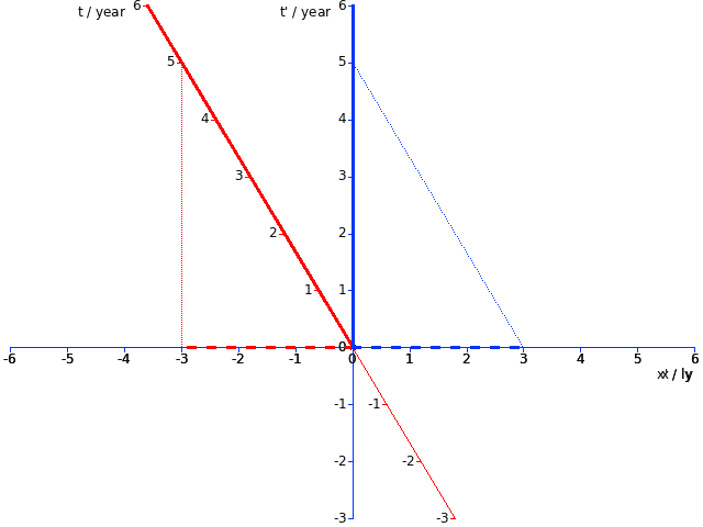

Geometrically speaking, reduce the complexities of a (3+1)d-Spacetime by working in the plane made by the two worldlines and define their x-axes to lie on that plane. (This is the Spacetime interpretation of “let’s assume that the observers have a relative velocity along their x-axes”.)
So, we can draw the usual (1+1)d-spacetime diagrams so that each observer can find the spatial and time components of a displacement along the other worldline to define that worldline’s spatial velocity in the observer’s frame.
Yes, this can be formalized by writing projections operations (which is what we mean when we say “find the components” in some frame).

  • #32
Ibix said:
So the point you are making is that the two inertial frames have different notions of "space", which are non-parallel 3d planes in 4d spacetime. Since my measurement of your three-velocity lies in my spatial plane, and your measurement of my three-velocity lies in your spatial plane, those vectors cannot be parallel.
For simplicity's sake, perhaps we could just observe that if I define my +x direction to be the direction you are going, and you define your -x direction to be the direction that I am going then: our y and z directions coincide (or can be made to coincide); your x and t directions lie in the plane defined by my x' and t' directions and vice versa; we measure equal three velocity magnitudes for each other; we regard those velocities to have opposite signs.
Let's expand on this a bit.
If I aim a laser pointer in the direction that I say you are travelling, and you aim one in the direction you say that I am travelling, every frame will agree that the three-velocities of the two beams are anti-parallel (actually this is restricted to frames moving in the ##\pm x## direction, although similar statements can be constructed in any other frame). This is the sense that people mean when they say that the two velocities are opposite. We are thinking of something like a pair of trains traveling away from each other along a straight track.
However, as @etotheipi and @robphy will agree, the three-velocities of those laser beams are not the three-velocities of the two observers. If we state the (correct) usual claim formally, it says that if I define your three-velocity to be ##(\frac{dx}{dt},\frac{dy}{dt},\frac{dz}{dt})=(v,0,0)## then you will define my three velocity to be ##(\frac{dx'}{dt'},\frac{dy'}{dt'},\frac{dz'}{dt'})=(-v,0,0)##. This is correct. However, despite the components being the same with opposite signs, it does not mean that the velocities are opposite because we are not using the same coordinate system. We need to find a way to express your measure of my three-velocity in my coordinate system if we want to compare them.
The way to do that is to note that a spacelike three-vector is three components of a four-vector with the fourth component being zero (this is the same as a two-vector ##(x,y)## in a plane being expressible as a three-vector ##(x,y,0)##). My measure of your three-velocity can be written in my un-primed coordinates as a four-vector ##(0,v,0,0)## (this is a purely spacelike vector lying in my "space" plane, not your four-velocity). Your measure of my three-velocity can be written in your primed coordinates as the four-vector ##(0,-v,0,0)##. Now I should apply the inverse Lorentz transforms to your measure, which maps ##(0,-v,0,0)## to ##(-\gamma v^2/c,-\gamma v,0,0)##. This latter form is in my coordinate system, and is clearly not parallel to ##(0,-v,0,0)##.
So, to summarise, there are good senses in which you and I can be said to be traveling in opposite directions. It is also true that if I say that you have a speed of ##v## in the ##+x## direction then you will say I have a speed of ##v## in the ##-x## direction. However, since we don't share a common definition of "space", we cannot correctly say that our three-velocities (even extending them to four vectors) are anti-parallel. We can only say that they lie in the plane defined by our two four-velocities.

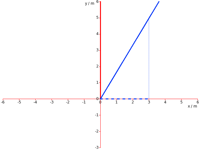

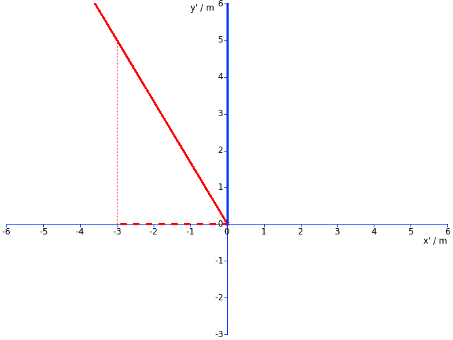

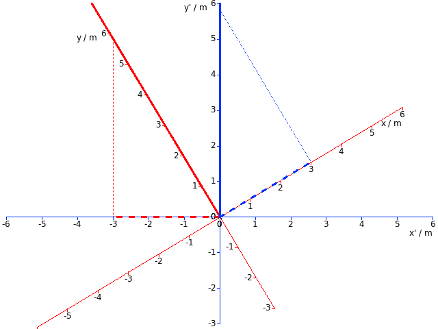

  • #34
It's important to realize that this issue about working in the plane of these worldlines
and these non-parallel spatial axes
is NOT just about Minkowski spacetime.
This is what we do in Euclidean space!
(Look at the x and x' axes in Euclidean space.)
From this unified [Cayley-Klein geometry] point of view (admittedly viewed in historical hindsight),
one should realize that
it is the Galilean case that is the special-case, the exception, the peculiarity!
But our everyday low-relative-speed "common sense" has
misled us to believe in the Galilean structure
...and makes it hard for us
to accept the Einstein-relativity/Minkowski-spacetime viewpoint [which agrees with experiment].

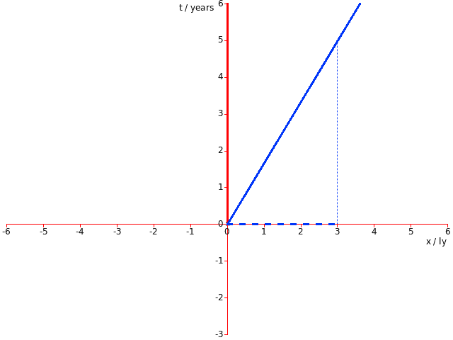

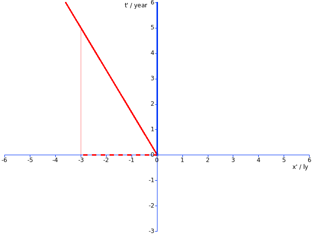

  • #42
Kairos said:
The effect of velocity on time dilation is orientation-independent but the Doppler effect depends on orientation, so when the vectors are not parallel, can the two inertial observers perceive a different Doppler effect?
If we imagine that object ##B## has coordinates ##(t, x_0 + v_xt, y_0 + v_yt, z_0 + v_zt)## in object ##A##'s rest frame. The components ##(v_x, v_y, v_z)## define a three-vector, which we can take to be the new x-axis. Likewise we can take the new y-axis so that object ##B## has coordinates ##(t, x_0 + vt, y_0, 0)##, where we take ##v > 0## and ##y_0 > 0##..
Now object ##B## can do the same and choose axes so that ##A## has coordinates ##(t', v't', y'_0)##, where again we take ##v' > 0, y'_0 > 0##.
The question is: do we necessarily have ##v = v', x_0 = x'_0, y_0 = y'_0 ##?
My argument is that, by the isotropy and homogeneity of spacetime, we must. We must have complete symmetry of these coordinates. Relative motion must be physically completely symmetric.
Moreover, we could take the point of closest approach to define ##t = 0## and ##t' = 0## in each case.
Note that I've changed strategy to make the displacements and velocities the same, rather than negatives of each other, which further emphasises the symmetry.
By this argument, there must also be completely symmetric Doppler shift.

Thank you, I already knows that and #39, but that's not the point:
Is the "non-reciprocity" of relative velocity (introduced above in this thread) compatible with the reciprocity of the Doppler effect. If not, is the admitted reciprocity of the Doppler effect in SR also matter of debate.
  • #46
What do you mean with "reciprocity"? There is no matter of debate concerning the Doppler effect in SR (nor in GR). For em. waves in vacuo you find the complete explanation of the Doppler effect already in Einstein's paper of 1905!
  • #47
The apparent non-reciprocity of relative velocity is a coordinate effect, resulting by considering the velocities in a wider context, with a necessary convention for spatial coordinate axes.
Post #42 shows that if we consider only the two objects in relative motion, then we can choose coordinates so that the relative motion is seen to be physically completely symmetric. Using those coordinates, we can see that any effects, such as the Doppler effect,must be symmetric.
Note that if either A or B uses a different coordinate system than that proposed in post #42, then the complete physical symmetry of the situation may not be immediately apparent. In that case, it may take yet more mathematical bravura to show the complete physical symmetry of relative inertial motion.
Likes Kairos
