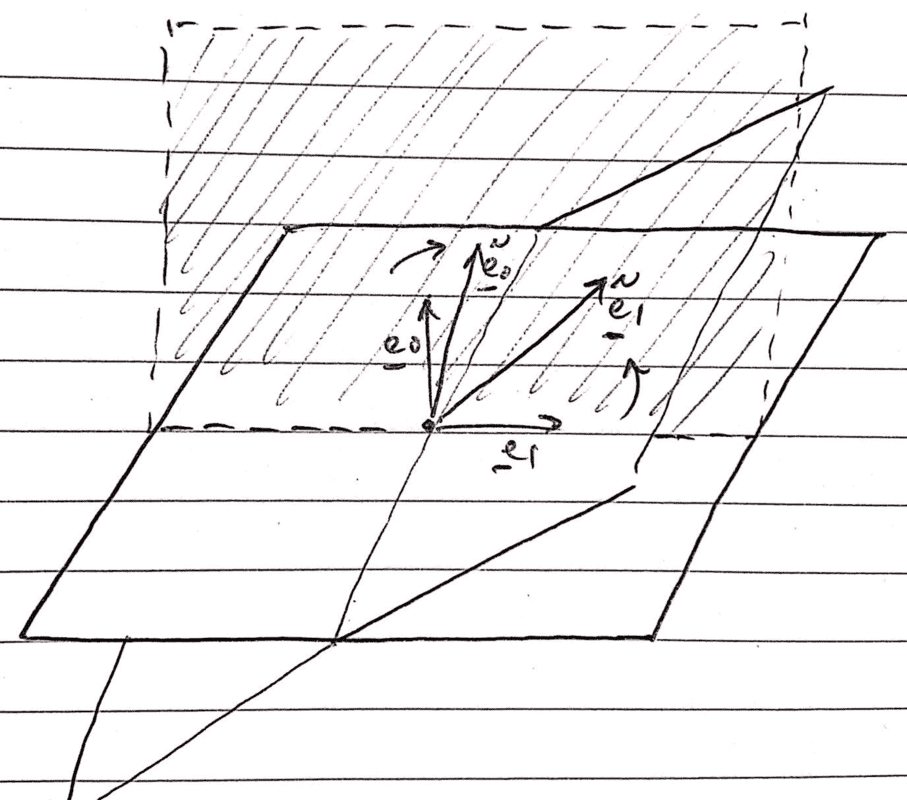

Since we can always define a unique axis of reciprocal uniform motion in SR, I don't see how it cannot be parallel to itself. But I am not skilled enough to judge your argument, so I trust you.
Ibix said:
I think everyone else is talking about the three velocity, which pre-supposes certain things, like an inertial frame.
Sure, but they are in correspondence as per the end of #19, so there's no loss in generality. It's just easier to write formulae with their 4-vector equivalents.
But it doesn't matter whether they are inertial observers, it still holds that their relative velocities defined in the standard manner are not parallel. Of course given suitable charts for each observer, e.g. as in #22, you can map these vectors to their respective co-ordinate spaces in such a way that the images are oppositely oriented co-ordinate vectors.
Okay, here's the proof, which is relatively short. Consider two observers, of 4-velocities ##u_1^a## and ##u_2^a##. At the intersection of their world-lines, or if they are inertial observers, then the relative velocity of ##O_2## with respect to ##O_1##, ##(v_{21})^a = \frac{\mathrm{d}x^i}{\mathrm{d}t} (e_i)^a##, may be obtained via the orthogonal decomposition$$u_2^a = \gamma(u_1^a + (v_{21})^a)$$Thus, we may write two equations,\begin{align*}
u_2^a &= \gamma(u_1^a + (v_{21})^a) \quad \quad \quad(1) \\
u_1^a &= \gamma(u_2^a + (v_{12})^a) \quad \quad \quad (2)
\end{align*}Let's substitute ##(2)## into ##(1)##, i.e.\begin{align*}
u_2^a &= \gamma[\gamma(u_2^a + (v_{12})^a) + (v_{21})^a] \\
\gamma^{-1} u_2^a - \gamma(u_2^a + (v_{12})^a) &= (v_{21})^a \\
-\gamma (-\gamma^{-2} u_2^a + u_2^a + (v_{12})^a) &= (v_{21})^a \\
-\gamma ((v_{12})^a + u_2^a(1 -\gamma^{-2})) &= (v_{21})^a \\
-\gamma ((v_{12})^a + (v_{12})_b (v_{12})^b u_2^a ) &= (v_{21})^a
\end{align*}This proves the result!
etotheipi said:
But it doesn't matter whether they are inertial observers, it still holds that their relative velocities defined in the standard manner are not parallel. Of course given suitable charts for each observer, e.g. as in #22, you can map these vectors to their respective co-ordinate spaces in such a way that they appear to be oppositely oriented co-ordinate vectors.
So the point you are making is that the two inertial frames have different notions of "space", which are non-parallel 3d planes in 4d spacetime. Since my measurement of your three-velocity lies in my spatial plane, and your measurement of my three-velocity lies in your spatial plane, those vectors cannot be parallel.
For simplicity's sake, perhaps we could just observe that if I define my +x direction to be the direction you are going, and you define your -x direction to be the direction that I am going then: our y and z directions coincide (or can be made to coincide); your x and t directions lie in the plane defined by my x' and t' directions and vice versa; we measure equal three velocity magnitudes for each other; we regard those velocities to have opposite signs.
Yeah, absolutely. I tried to draw it, of course suppressing one dimension (beware, it's a slightly awful drawing...)
The "flat" plane is the rest space of ##O_1##, and the "tilted" plane is the rest space of ##O_2##. The "dotted, vertical plane" is the plane of the Lorentz boost, in which the ##\mathbf{e}_0## and ##\mathbf{e}_1## vectors have been rotated into the ##\tilde{\mathbf{e}}_0## and ##\tilde{\mathbf{e}}_1## vectors.
