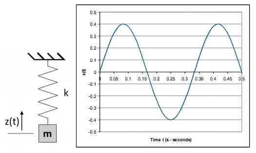

A mass-spring system is in free vibration after an initial excitation. There are no outside forces acting on the system. What is the value of the spring stiffness k (units of N/m; round your answer to a single decimal place)?
Mass m = 0.6 kg
Amplitude A = 0.4
Using this equation:
z(t) = A sin (w0 t)
Where w0 = SQUARE ROOT k/m
k is in the unit N/m and m is in the unit kg

You cannot determine ωo or k from the given information. Is the question statement word-for-word complete?

Yes, that's the entire question. There is also a graph if that helps at all.
The graph is key to the problem. What information can you glean from the graph?
Amplitude, frequency, and period.
Is frequency equal to ω0?
And frequency I believe would be 3, correct?
Period T (Seconds) and frequency f (Hz) are both related to angular frequency ω (radians / sec). Do you know the relationships between these quantities? It comes up a lot so it's worth committing to memory.
Angular frequency is equal to 2πf, if I remember correctly. So since f=3 in this example, would angular frequency be equal to 6π?
Yes, but be sure to always include units when you quote values. In most cases in physics (and all sciences) a number alone is meaningless.
So f = 3 Hz and ω = 6π rad/sec.
Okay, that works out! Thank you so much for your help!
You're welcome. Good luck with your studies.
