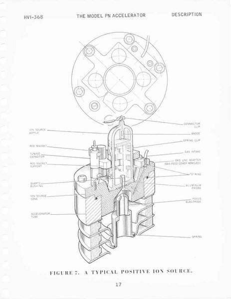

I'm using a model PN-250 positive ion accelerator from High Voltage Engineering Corporation, and I was wondering how the beam focus works.
The electric field used to accelerate our protons is generated by a stack of ten plates with voltages stepped down by 10 MOhm resistors. The focus control isconnected to the second plate from the top of the stack.

To clarify, the focus I'm asking about modifies the electric field of the acceleration column in some way to affect beam spread directly from the accelerator. We use magnets to analyze, steer and focus further down the beamline, but I know how those work.

I've scanned the relevant page from the manual
Ok, thanks. I see it better now. This is an assembly that includes the ion source and extraction electrode in Varian terms. So this presumably is not the entire acceleration, right? The close spacing of the pieces and the number of them seems to me to exclude and acceleration voltage of more than 30 or 40 Kev I think. Isn't there another acceleration tube after all this assembly? It would seem you would need that if you want 100 or 200 Kev of acceleration. You clearly would not get to 200 Kev with just that source assembly. It appears to be an ionization chamber source, one which Varian gave up after the early years, going instead to an actively heated source, with a tungsten filament about 0.01 in diameter fed with something like 400 watts, couple of volts and up to 200 amps which brute force ionized the gas fed into the chamber followed by extraction electrodes made of graphite with a narrow slit about a half inch long that gave out a ribbon shaped ion beam which was focused down to a beam about the size of a #2 pencil and then various scan techniques to allow implanting of said ion under the surface of a silicon wafer, or sometimes other substrates like sapphire or glass or GaAs and the like. We implanted mainly phos, boron, or arsenic to allow doping of the silicon into conduction with tight depth control via a variable acceleration voltage, sometimes even slowing down the extraction Kev to something like 5 Kev for very shallow implants. That meant reversing the acceleration voltage potential and decelerating the ion beam instead. It is interesting to me the smaller and smaller features of modern computer and memory chips require smaller and smaller accel voltages, some down to a few hundred volts because as the chip features get smaller so does the needed depth of implant so the newest implanters are more like desktop machines not needing the huge 200 Kev power supplies or even the 40 or so odd Kev of the source extraction supply. The beam current is still tied to the extraction voltage so I imagine if they want a heavy implant at say, 400 volts (0.4 Kev) They would have to have a decel mode PS to buck the higher extraction voltage. Of course they may have evolved even better extraction ion sources, haven't kept up with the details of the latest low voltage machines.
So anyway, do your machines have more acceleration downwind from the ion source assembly you show in the diagram? I know the graphite extraction electrode does do focus duty by the shape of the electrode, carefully sculpting electric lines of force. So the surface shape is hyperbolic, kind of like a pair of eye glass lenses, one curve on back surface and another on the front. I don't think that works at 200 Kev energy levels however which is why I think Varian went with PM magnet focus assemblies which of course uses no power, just bends the beam inwards effectively. It has a null field in the center of the beamline and any stray ions gets nudged back into place when they arrive at the focus assembly out of the beamline center. Anyway, I guess there is more than one way to focus a beam.
Yeah, there's a total of ten acceleration plates. Nominal beam energy is 250 keV and we can only get that using a buffer gas. I understand how the protons we accelerate are generated and accelerate, I'm just not sure how this focus electrode affects the beam. We don't do ion implantation. This is an old accelerator which we intend to use as a teaching apparatus. Experiments performed include rutherford scatter/backscatter spectroscopy and particle-induced x-ray emission spectroscopy.
The focus electrode is highly effective as a rough focus, though we do use quadrupole electromagnets to adjust beam geometry just before the target chamber.

I realize this is an old topic, but electrostatic lensing and focusing has been a reality for quite some time. The extraction electrode itself generally has an electrostatic focusing property, a can of sorts, that serves to begin the beam shaping prior to source exit. I have never seen an electrostatic analyzer at an angle however, generally RF and DC are used to oscillate ions, and the ones at the right weight pass through the quads or hexapoles and either get scanned electrically or resolved and conditioned further along. Those outside the m/z range oscillate beyond the poles and are lost. Some of these applications use collision induced dissociation (mass spectrometry) to create daughter ions, but that's a different game.
