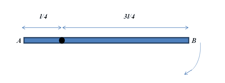

In several questions in rotational dynamics they ask the trend in angular acceleration and angular velocity.In one of them they released a rod from horizontal position and asked if the angular velocity and angular acceleration are increasing/decreasing In another one they release a square sheet but the trend is different.
Is there a concrete and easy way to figure this out.have a very happy new year!

The square is pivoted at vertex D and initially held at rest so that sides AB and CD are horizontal. After it is released, the plate swings downward, rotating about the pivot point.
https://courses.edx.org/asset-v1:MI...k/pivoted_falling_square_with_overlay_cac.svg
A rod of mass m is pivoted in the horizontal position as shown (black point). The rod is at rest and then released.
A uniform bar of mass m and length L is pivoted at one end and is held vertically as shown. After the bar is released, it swings downward with no friction in the pivot.
these questions are getting on my nerves.Because they seem the same but are not.
for the fist one α and ω both are increasing and for the second one α decreases while ω increases .(I don't know why)and the third one is the weirdest as the answer says that the α=0
so I thought I could calculate ω with mechanical energy conservation considering the intermediate state and the final state but that's wrong too.
##mg(L/2)=0.5 *((mL^2/12)+(ml^2/4)) *ω^2##
##ω=sqrt(3*g/L)##
but the answer has 6g/L
what am I missing?

The difference between the three arrangements is where the pendulum starts in its motion. In the first, it starts at 45 degrees above horizontal. In all cases, maximum angular acceleration will be in the horizontal position, so in the first one it initially increases. In the second, I would have guessed the rate of change of angular acceleration was initially zero, but soon goes negative, giving a reducing angular acceleration.
I think you have not completely stated the third question. Without some initial nudge, there is no reason for it to fall. Certainly there is no initial angular acceleration. Why would there be any? There is no torque about the pivot when the rod is vertical. But the angular acceleration soon increases, so the angular velocity increases too.
Didn't understand your Edit 2. Do you mean to ask whether the acceleration vector is radial?

Just as linear acceleration results from force, angular acceleration results from torque.
Constant torque produces constant angular acceleration. That would occur e.g. with a weight hanging from a rotating drum.
In a pendulum you have a constant force, mg, but the torque about the pivot depends on the angle, so the angular acceleration varies. Maximum torque is when the line of action of mg is as far from the pivot as it can go. That will be when the mass centre is on the same horizontal level as the pivot.

Does that surprise you? L is clearly the right value to use for the height lost by the mass centre, no?

for the first two problems ω is increasing because of the direction of rotation- clockwise .
are the trends in α (which I understand now ) related to the trends in ω?

I understand that for the square sheet α increases and for the blue rod α decreases.but in these questions we are either using Newton's second law (a and α) or energy conservation and transformation.
How do I know that ω increases for both of them ?

Yes, the sense of the problem is if α and ω have the same sign, then the rotational speed is increasing.
back in linear motion if a and v had the same sigh it meant "speeding up" .
I get the impression you feel there's an inconsistency there. It's completely consistent. As Sammy writes, in these problems ##\alpha## and ##\omega## have the same signs, so the rotation is speeding up. Whether ##\alpha## is increasing or decreasing in magnitude is another matter; that would correspond to a increasing or decreasing in magnitude.
