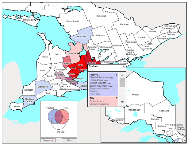

For my client, I made this one-page vanillaJS app that shows a heat map of counties serviced by their three professions (if they add a fourth I'm screwed):

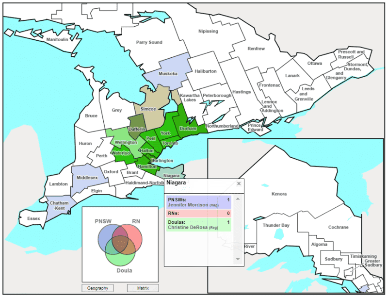

The Niagara county is serviced by one PNSW and one Doula, so its hotspot is a pale blue-green:
Map of southern Ontario counties shaded green where served by the three professions, with a legend showing PNSW, RN and Doula overlap and an inset showing Niagara's workers.
If you want to only see Registered Nurses, you can turn the others off using the trefoil-like legend:
Choropleth map of Ontario counties shaded by provider coverage, with a Venn diagram legend for PNSW, RN and Doula and a popup listing Durham providers.

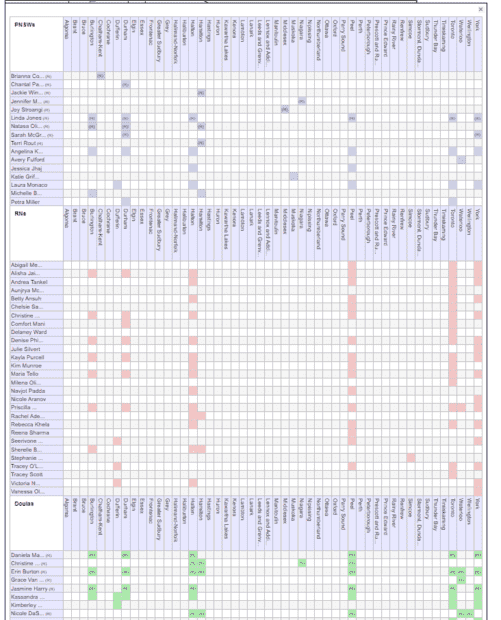

There's also a "just show me the data" overlay:
Spreadsheet-style grid of worker names as rows and Ontario counties as columns, with shaded cells marking which counties each worker serves.
