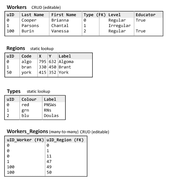

Is there a middle-ground between a local read-only data file (such as a JSON object) and a full-blown SQL-like database? Specifically, something can can be edited?
Over in this thread I've outlined a one-page web app that uses a tiny data store composed of a couple of JSON objects. There's only 100 or so rows of data, but it is updated regularly. Currently, I rely on the client to let me know when there are changes and I update the .js file manually and upload it. I want to give the client the ability to make routine data changes at-will (Create, Read, Update, Delete).
The app is for internal use - it is not exposed to the public. Really, it serves no function that couldn't be accomplished by a simple document or spreadsheet - except to visualize the data geographically. (In fact, the data I use to update it is currently updated by the client in a Google doc, but it's not sufficiently well-defined to use as a data source, using area descriptions like "everything west of..." or "... and surrounding area"). Once the data is dynamic, I can create a editing page that will allow (i.e. force) the client to explicitly choose regions from a list/map.
I do not want to go with a full-flown SQL database for a couple of reasons associated with portability and upkeep. I don't want to be messing around with the client's webhost features and settings like I would have to do to set up a database.
Is there no middle-ground between a read-only, local data file and a full-blown database?
I thought NoSQL sounded like a solution, but it isn't what I thought.
As for security, right now I simply have a webhost-based pass-wall on the whole folder, so the site can't even be seen - let alone edited - without permissions. The only private data is workers' names - there's no other meaningful personal data in this app.
Here's the entire schema, currently stored in JSON objects in a .js file in a subfolder:
Four small tables of data: Workers (uID, Last Name, First Name, Type, Level, Educator), Regions (uID, Code, X, Y, Label), Types (uID, Colour, Label), and a Workers_Regions junction table linking worker and region IDs.

Isn't step one to figure out if the schema is right, and then figure out what supports what's needed? It looks like it will be doing JOINs left, right and center, which is at odds with "simple".
When we are looking at a small amount of data, as we are here, you don't need normalisation, you can just store everything in one large object held in memory.
That's insane. If you are storing javascript objects you don't need a "table" for many-to-many joins, and you certainly don't want it to look like that in memory. And creating arbitrary unique IDs for things is daft.

Sorry. Y'all caught me in a flub. The schema is something I designed to show a friend as a relational database.
The actual JSON is like this:

Ah, y'all have given me a lot to chew on. I didn't realize (or quite possibly have simply forgotten) there were so many options. I will take time to process.
OK, a colleague has recommended SQLite. It seems to be what I'm looking for, but I have a few specific questions.
  1. I have to download and install it. Presumably, that is just for the sake of developing in it. I hope that all I'm doing to deploy it is upload a bunch of files in my webhost, yes? i.e. no web host configuration such as install server-side apps and db activation like I would have to do for a full db-based app.
  2. I get the feeling that, even though the db is a flat file(s), it's not text-editable, yes? During dev I would edit it in immediate mode via the developer interface.
  3. My web app needs to have a data control layer. I hope that layer can be in client-side JavaScript? Or do I still need a server-side script like PHP?
My goal is to have:
  • two pages: a data visualization page and a data edit page.
  • possibly under two different logins: eg: user and admin.
  • eventual portability to client's site, presumably all I have to do is upload the files to their webhost and set up login permissions there. Other than those permissions, I hope there's no configuration that needs to be done on the client's web host.
