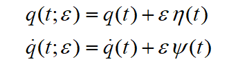

To carry out the machinery of Hamilton's Principle though the calculus of variations, we desire to vary the position and velocity, independently.

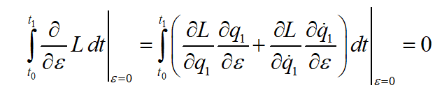

We proceed by varying at action, and set the variation to zero (I will assume ONE generalized variable: q1)
In the above, I can see how we vary both q and q-dot independently: it is (if I am not mistaken) in the "machinery" of taking both partials of q and 1-dot). So far, I am fine with that: it initially appears as if position and velocity were independent.

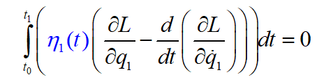

And we extract the Euler Lagrange equation.

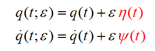

However, if I were to look more closely, I see that this work began with:
And if this is the case, I do NOT see how q and q-dot are varying independently, because both have the same eta function in their "heritage."
I can see the "intent" that they vary independently (through the "blind"-machinery of taking the partial with respect to q and q-dot, but ultimately, they are not independent, unless the two red functions were different
Could someone advise me?

Trying2Learn said:
TL;DR Summary: Where, in the mathematical work out, do we use the fact that position and velocity are varying independently?
we do not vary them independently
Likes topsquark, Trying2Learn and vanhees71
Oh... in your simple response, I reread things and now see I misunderstood what I had read.
thank you
