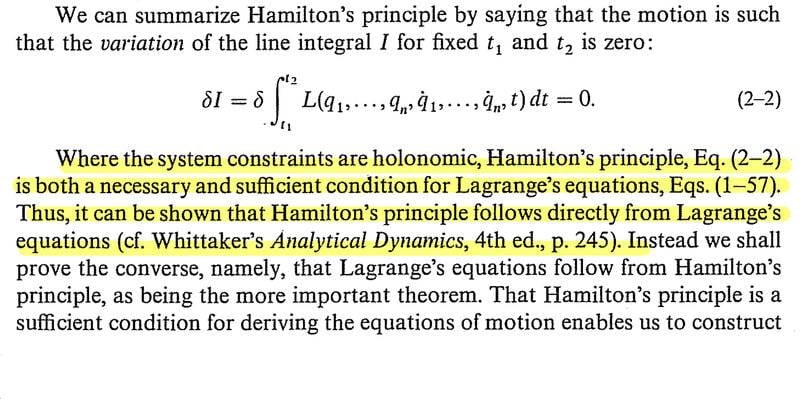

Goldstein 2ed pg 36
Textbook page showing Hamilton's principle: delta I equals zero, with I the integral from t1 to t2 of L(q, q-dot, t) dt, equation (2-2), plus highlighted text on holonomic constraints and Lagrange's equations.
So in the case of holonomic constraints we can move back and forth between Hamiltons principle and Lagrange equations given as ##\frac{d}{d t}\left(\frac{\partial L}{\partial \dot{q}_{j}}\right)-\frac{\partial L}{\partial q_{j}}=0##
But the Lagrange equations were derived from DAlembets principal Assuming that the virtual work of constraints is zero. But in the Hamilton‘s principal, we don’t see that the constraints should be workless .
Is it implicitly assumed that the virtual work of constraints is zero in Hamilton‘s principal?
How can we prove it?

To arrive at those El equations via DAlembert we begin by assuming workless constraints.
So it makes sense if that assumption is built in the Hamilton principle.
Is that so?

Thanks but I think that doesn't answer the question.
I know what Hamilton's principle is and how we can deduce EL equations via it using stationary integral of Lagrangian.
vanhees71 said:
Then I don't understand the question.
1) we can get EL equations via DAlemberts principle for the case of conservative systems.
However a crucial step while deriving those equations is that we assume that the virtual work of constraints is zero. Such constraints are also known as workless constraints.
2) Hamilton's principle is equivalent to DAlemberts principle for holonomic case. Obviously we get the same EL equations as with DAlemberts principle. Question:
Why doesn't the assumption of workless constraints enter when we use Hamilton's principle for holonomic constraints?
