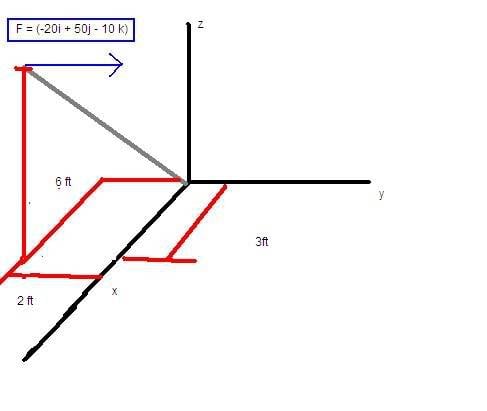

Given F = (-20i + 50j = 10k)
1. The component of the foce projected along the pole AO.
2. The magnitude of the projected component of the F along the pole AO.
I have no idea where to begin, I think I need to find the angles but I'm not sure how in three dimensions.
(please excuse the picture...i know its not the greatest)

No, you don't need to find the angles …
you're thinking of the formula F cosθ for the component of force F in a direction at an angle θ.
But you can also use the formula F.n, the direct product of the force and the unit vector in that direction …
and when the question gives you the coordinates, that's a lot easier! :wink:
so the unit vector would be ...
position vector of pole = r = 3i - 2j + 6k)
length of r = l = sqrt(3^2 + 2^2 + 6^2) = 7
u = r/l = 3/7i - 2/7 j + 6/7 k
is that right?
then take that times the force vector given?
clickcaptain said:
… is that right?
Yup! :biggrin:
(though I would have waited until the next step before dividing by 7 … :wink:)
(you mean dot, not times, of course :wink:)
Yes … that gives you the component of force along that direction. :smile:
