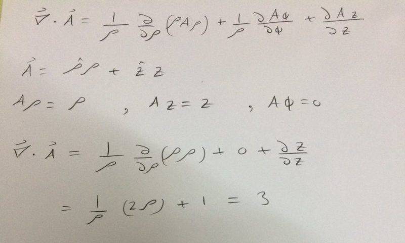

i have added my solution for the first few equations. My problem is page 3 and page 4. I can't get the right answer.
Well, can you pick the one that's wrong ? 2 out of 3 say 3, so maybe the odd one out is the 'ccs'. What could be the problem here ?
Yes my problem is ##3.\triangledown\cdot r## in C.c.s. I don't know how to get 3 as result like R.c.s which is the correct answer.
and my solution for the S.c.s I am not sure if its correct. Its seems wrong.
I added the others so you can see how i solve the equations.

don't help you much further at the moment :rolleyes:. I seem to remember quite different expressions for ##\nabla\cdot \vec A##. Could you check, e.g. here ?
Thank you. You are great. I think i get it.
I have uploaded an image with the solution. Sorry that i don't use Latex but I am on mobile phone right now.
Is this correct?
Well done. A few more exercises are waiting ... :smile:
thank you again. Than my solution for spherical is also wrong. ( on page 4)
Indeed, the first two lines were some kind of inspiration ? After that, it looks pretty convincing !
