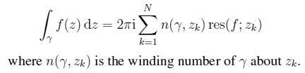

Use the residue theorem! Don't mess with antiderivatives if there are singularities around.
OK, so turning to the residue theorem:
The singularities of [itex]\displaystyle f(z) = \frac{2z}{z^2+w^2}[/itex] are [itex]\pm iw[/itex].
[itex]\text{res}(f,\pm iw) = 1[/itex].
The contour [itex]\gamma[/itex] is a positively oriented unit circle.
So if [itex]w \in [-1,1][/itex] then the winding number [itex]n ( \gamma , \pm iw ) =1[/itex]. If [itex]w \notin [-1,1][/itex] then the winding number [itex]n ( \gamma , \pm iw ) =0[/itex].
So [tex]2\pi i \times I = 2\pi i \left( \pm iw \times 1 \right)[/tex] for [itex]w\in [-1,1][/itex] and [itex]I=0[/itex] otherwise?

The residues aren't [itex]\pm iw[/itex]. They are 1, as you said. Fix your final answer. And they want you to consider w as a complex parameter, describing it using interval notation is for real numbers. And you might want to think about the case |w|=1 separately. But that's a good start. Just needs a little fixing.
Dick said:
The residues aren't [itex]\pm iw[/itex]. They are 1. Fix your final answer. And they want you to consider w as a complex parameter, describing it using interval notation is for real numbers. And you might want to think about the case |w|=1 separately. But that's a good start. Just needs a little fixing.
The singularities are [itex]\pm iw[/itex] ; the residues are 1 - correct?
[itex]I = (1 \times 1 + 1 \times 1) = 2[/itex] if [itex]-1 < \text{Re}(w) < 1[/itex] and [itex]-i <\text{Im}(w) < i[/itex].
and [itex]I=0[/itex] if [itex]\text{Re}(w) < -1[/itex] or [itex]\text{Re}(w) > 1[/itex] or [itex]\text{Im}(w) < -i[/itex] or [itex]\text{Im}(w) > i[/itex]
If [itex]|w|=1[/itex] is the winding number still 1?

So the integral is 4*pi*i if w inside of the contour right? The region you are describing sounds like a square to me. And the contour is round. If |w|=1 then your contour integral is singular, isn't it? The poles will be on the contour. You can still assign the integral a value if you interpret it as a Cauchy principal value, if you covered that.

I think I=2 as that factor of [itex]2\pi i[/itex] gets canceled by that of the original integral. Why is the integral 'singular' if [itex]|w|=1[/itex]? And yes, I know the contour is a circle but I'm having trouble describing it - I now see I was describing a square before!

Right. The original definition cancels the 2*pi*i. The integral is singular if |w|=1 because then iw is on the unit circle. You'll get a zero in the denominator as you integrate. What's wrong with |w|<1 as a description of the interior of the unit circle?

I don't know why I didn't think to describe [itex]w[/itex] like that. Does this description of [itex]I[/itex] look OK:
[tex]I = \left\{ \begin{array}{lr} <br /> 2 & : \;|w|< 1\\ <br /> 0 & : \;|w|>1\\<br /> \text{undefined} & : \; |w|=1 <br /> \end{array} <br /> \right.[/tex]

Looks fine. Like I said before, if you take the principal value sense of the integral you could show you get 1 for |w|=1, but if you haven't covered that, don't worry about it.
