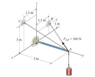

I need to find the components of the force along AB along AC.
So I got unit vectors for each like so:
\vec{AB}=&lt;-1.5,-3,1&gt;
\vec{AC}=&lt;-1.5,-3,3&gt;
Norm AB=sqrt(12.25). Norm AC=sqrt(20.25).
Then after multiplying the unit vector AB by the force I tried using the vector projection formula:
proj_{\vec{AB}}{\vec{AC}}=\frac{\vec{AB}\cdot\vec{AC}}{\norm{AB}\norm{AC}} \vec{AC}
But my answer was wrong. I don't know what the right answer is.
Verify the components of your vectors, paying attention to the directions of the axes.
I see, I had a - in the x component of AC. That did it, thanks.
