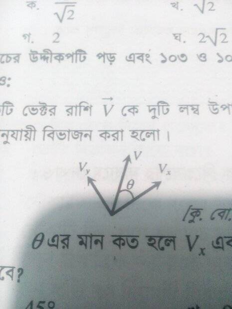

Find value of ##\theta## when ##V_x=V_y##
Vector
The picture may be blurry. I couldn't take more less blurry picture hence, giving it.
The question is : Find value of ##\theta## when ##V_x## component and ##V_y## component same.
I was using a simple equation of vector.
$$C=\sqrt{A^2+B^2+2AB\cos\theta}$$
$$V=\sqrt{V_x^2+V_y^2+2V_xV_y\cos\theta}$$
$$=\sqrt{2V_x^2+2V_x^2\cos\theta}$$
$$=\sqrt{2V_x^2(1+\cos\theta)}$$
$$=V_x\sqrt{2 \cdot 2\cos^2(\frac{\theta}{2})}$$
$$=2V_x\cos\frac{\theta}{2}$$
$$2\cos^{-1}\frac{V}{2V_x}=\theta$$
Somehow, I took ##V=V_x## cause, I couldn't get any other way to remove them. When I took ##V=V_x## then, I got ##\theta=120 \deg##. But, which was completely wrong. The answer was ##45 \deg##. I was trying to use another equation. ##\vec A \cdot \vec B=AB\cos\theta##; Using the equation I got ##0## which is 100% wrong.
Your $$V=\sqrt{V_x^2+V_y^2+2V_xV_y\cos\theta}$$ is a formula to calculate the length of ##\vec V## as the sum of ##\vec V_x## and ##\vec V_y## when the angle between ##\vec V_x## and ##\vec V_y## is ##\theta##. That angle is ##\ \pi/2\ ##, so the result is $$V=\sqrt{V_x^2+V_y^2}$$from which you can derive ##V## in terms of ##V_x##.
Your other equation $$\vec A \cdot \vec B=AB\cos\theta$$can then be used to find the angle between ##\vec V## and ##\vec V_x##
##tan\theta = \frac {V_y}{V_x}##
Edit: If the x and y are the other way round (picture too blurry to be sure) then ##tan\theta = \frac {V_x}{V_y}##.

I got that $$V=\sqrt{2}V_x$$
so, when i put it in my main equation. I get $$2\cos^{-1}\sqrt{2}=\theta$$. But, cos inverse 1 of square root 2 is undefined.
##V=\sqrt{2}V_x## is correct.
I assume you mean you plugged it into this in post #1:
##2\cos^{-1}\frac{V}{2V_x}=\theta##
But you made a mistake in the algebra. If you do it correctly you will get the answer.

I found where the mistake is. Although, I got ##90 \deg## instead of ##45 \deg##. If there was no constant ##2## outside of cosine then, I would get ##45 \deg##. But, it wasn't accurate way to remove ##2##. According #2 the equation won't work here.
Yes, you are right ... I did not study post #1 carefully enough.
There you wrote
##V=\sqrt{V_x^2+V_y^2+2V_xV_y\cos\theta}##
but in that equation theta would be the angle between ##V_x## and ##V_y##, i.e. 90 degrees. So you should have deduced ##V=\sqrt{V_x^2+V_y^2}##, which leads to the same equation, ##V=\sqrt{2}V_x##, as you had in post #6, which gets you no further forward.
Instead, start again with ##\vec V=\vec V_x+\vec V_y## and take the dot product of each side with ##\vec V_x##.
