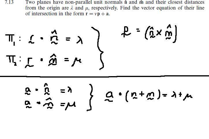

The question is attached in the picture.
I have found the direction vector of the intersection line, but I have yet to find a point that lies on both planes...
I've thought about having [itex]\hat{m}[/itex] and [itex]\hat{n}[/itex] as basis vectors, but i still lack 1 more vector as this question is in 3 dimensions..
OR
Since I am restricting the point to lie only on the line it can be considered as 2 dimensions?
and hence a = x[itex]\hat{m}[/itex] + y[itex]\hat{n}[/itex] ??
Then I can plug into the 2 plane equations and solve for x and y.

OR: work out the equations of the two planes and do it that way.
I see you tried - you end up with an equation of form [itex]\vec{u} \cdot \vec{a} = k[/itex] and the problem of finding a particular [itex]\vec{a}[/itex] knowing [itex]\vec{u}[/itex] and [itex]k[/itex].
The difficulty is singling out just the one unique a ... you need a way to pick one out.Normally, you'd hold one coordinate constant and find the other two.
http://members.tripod.com/vector_applications/xtion_of_two_planes/index.html
... that does not help you here as you need to express your result in terms of what you are given.
But consider: you know how to find some points and lines in each plane:
[itex]p=\mu\hat{m}[/itex] is the point of closest approach to the origin in plane M
[itex]q=\lambda\hat{n}[/itex] is the point of closest approach to origin in plane N
What is the line through point p, in the plane M, perpendicular to the line of intersection?
What is the vector through point q, in the plane N, perpendicular to the line of intersection?
Point a will be the point of intersection between these two lines.

1)the line would be p + Ω[itex]\hat{m}[/itex] (Parallel to normal of plane M)
2)The line would be q + σ[itex]\hat{n}[/itex] (Parallel to normal of plane N)
The intersection of the 2 lines is at the origin. I don't see how this helps in finding point a...

1. Form a plane that contains the origin (0, 0, 0) and the 2 normal vectors [itex]\hat{m}[/itex] and [itex]\hat{n}[/itex].
Thus any point on the plane would be:
r = x[itex]\hat{m}[/itex] + y[itex]\hat{n}[/itex]
for some x and some y.
Let r be point a where a is the intersection of this plane and the line.
Plug point a into plane M and plane N to solve for x and y.

Yes, you can choose the vector a = xn+ym.
Keep in mind that na=λ and ma=μ,
plugging in the expression for a:
xn2+ynm=λ,
xnm+ym2=μ.
You can solve for x, y in therms of n and m.

Yup, I solved it. Thanks for the help guys!
