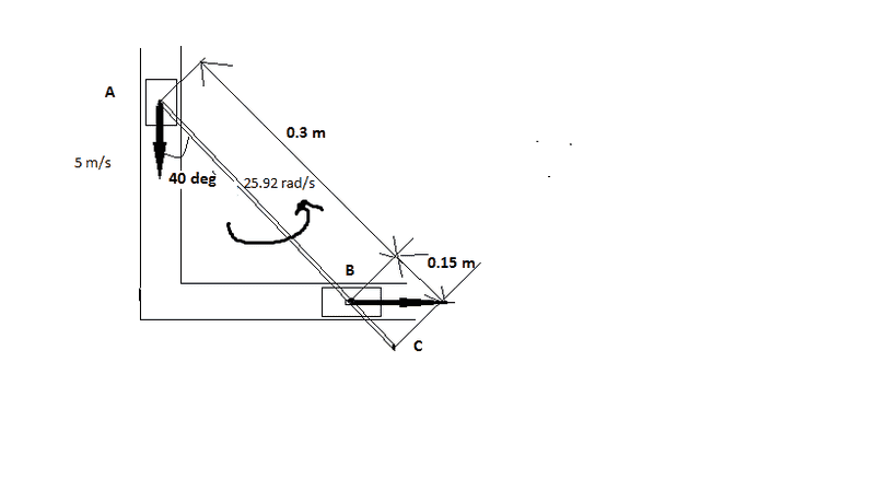

In the attached image, find angular velocity of the rod and the velocities at points B and C.
vB|A=0.3ω
How do I know what angle the absolute velocity makes with the other vectors when put in a triangle? How would the velocity vectors look like at point C in the attached image? It's hard for me since I only have one angle. I could calculate ω, vB, vB|A, I'm only left with vC
vB= 5.95 m/s
vB|A=7.778 m/s
Now, vC|A should be (0.3+0.15)*ω, but what do I do after that?

Please check if I have this right:
letters in bold are vectors.
rC|A=0.45sin(40°)i-0.15cos(40°)j
vA=-5j
vC|A= ω x rC|A
vC=vA+vC|A
I get vC=-5j+(2.979i +(edited) 7.943j) which is obviously wrong.
I don't get why the vC makes an angle of 15.61° with the horizontal, as given in my book!
That should be 0.45 on the cos as well, maybe that is it.

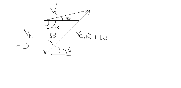

I've attached a diagram showing a graphical solution.
Vc will be up from the horizontal because Vb is flat horizontally. Vc|a is longer than Vb|a because r is larger at C so the resultant Vc will rise above the horizontal.

Yes, just in case:
The magnitude of Vc is found from the law of cosines:
Vc2 = Va2 + Vc|a2 - 2VaVc|a cos 50
and then the law of sines gets you alpha:
Vc/sin 50 = Vc|a/sin alpha
and
θc = alpha - 90I think it's probably equally difficult to do it this way or the cross product way; maybe a bit easier using your method because there are fewer things to think about.
The geometry does give some more insight though. All points on the rod AC travel at a velocity Va+Vp|a where Va is constant and pointing downward and Vp|a is always perpendicular to the rod. This means the one vector velocity diagram shows all velocities at every point of the rod :: any point's velocity is simply the sum of Va and a vector along Vc|a. The length you travel along Vc|a to find Vp|a depends on the distance r of the point p from a (the length is rw remember). So the tail of the absolute velocity of p is anchored at A and the head sweeps along the vector Vc|a for each point p. Vb, eg, is the horizontal vector I drew from A to the vector Vc|a in that diagram.
