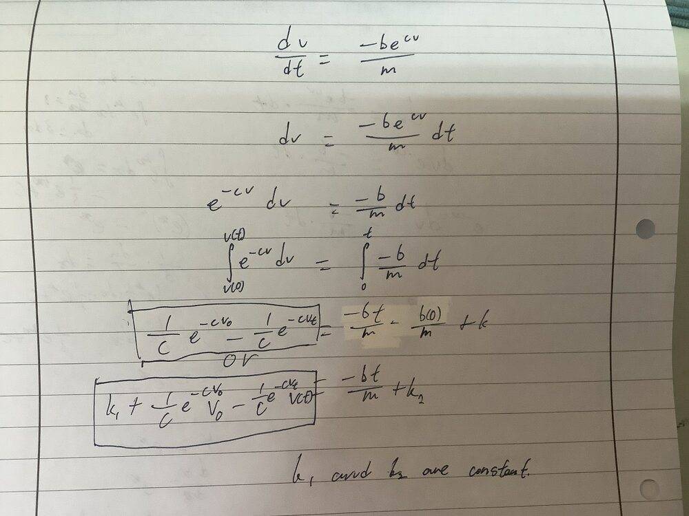

I don’t know I should write in which forms?
It is the dv is respond to the c(v) or it should be a variable refer to my picture?

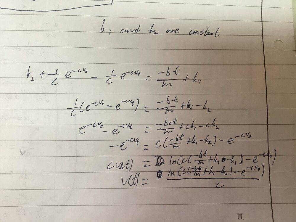

If my understanding is correct, it should be
If the constant k1 and k2 are not need to add on the equation(because of the t=0), the answer is at the upper part without the k.However, there are still lot of step that I am confused.
You certainly don’t need two constants, and substituting t=0 shows the constant is zero.
so I can ignore all constant k result in the integration?
but constant of the integration of v(t) will not equal to zero.

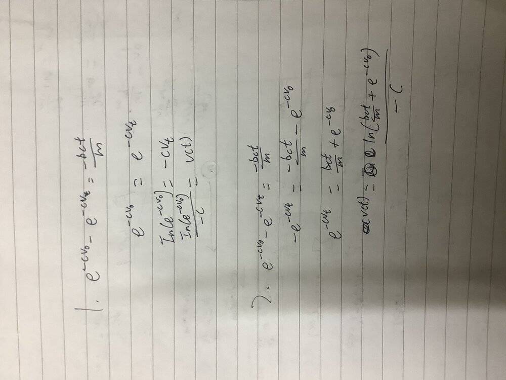

If my understanding to this question is correct,
I got the answer of :
##e^{-c v_0} - e^{-c v_t}=\frac {-b c t} m##
And I got:
##\frac {ln{\frac {b c t} m + e^{-c v_0}}} c##
If my understanding is correct, it should be View attachment 268502
I think you have a sign error that crept in near the end.
You had ##e^{-cv_0}-e^{-cv}=-\frac{bct}m##. Take it from there again.

As I have explained to you twice now, you do not need a constant of integration if you use the range bounds on both sides. Look what happens if we include a constant and plug in t=0:
##e^{-c v_0} - e^{-c v_t}=\frac {-b c t} m+k##
##e^{-c v_0} - e^{-c v_0}=0+k##
##0=k##

Post #21 was just to show you that you do not need a constant of integration because you used the form ##\int _0^t ... = \int _{v(0)}^{v(t) } ...##.
Your equations in post #19 are correct.
Ok, I am just scared of the result...
So my equation in post 19 is correct, my answer also correct?
So, using the post equation in 19, I got 2, but using the 25post ,I get 1.
It is the most simplified answer?
Ops, I forget, only 2 is the correct way, but is it the step is wrong?
