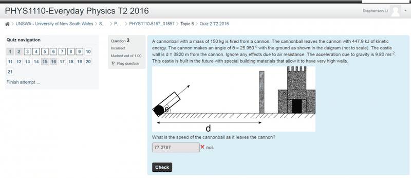

Hey guys, this question has boggled my mind not because I don't know how to approach it but apparently the method I'm using is incorrect!
Question
A cannonball with a mass of 150 kg is fired from a cannon. The cannonball leaves the cannon with 447.9 kJ of kinetic energy. The cannon makes an angle of θ = 25.950 o with the ground as shown in the diagram (not to scale). The castle wall is d = 3820 m from the cannon. Ignore any effects due to air resistance. The acceleration due to gravity is 9.80 ms-2. This castle is built in the future with special building materials that allow it to have very high walls.
What is the speed of the cannonball as it leaves the cannon?My Attempt
So considering I'm given KE & the mass and we want to find the velocity I used the formula KE=1/2(mv^2). I convert kJ to J as required and get 447900 = 1/2(150*v^2), solving for v; v=77.28 m/s.
I enter my solution and apparently it's wrong...
Can anyone evaluate my method and tell me if the system is crazy or I'm just approaching the question incorrectly. I have attached the image to the online quiz showing the question & diagram as well as the system saying I got it wrong when entering the supposed solution.

I agree with your answer but not the number of significant figures.
IME with those online quizzes is that they only accept an answer with the correct sig. figs.
Actually you would think that, but the instructor has said that the no. of sig figs don't matter and that we should put as many as possible to avoid rounding off error.
I guess you've tried entering the answer to different decimal places?
Yes, to no avail..
Stevemotto said:
Yes, to no avail..
Did you try 77.3?
Yep, still incorrect. I'm having some thoughts of the interaction of gravity on the velocity but that doesn't make sense and we aren't given time. Thinking of emailing the instructor..
If you have trials left over, you could guess the 150 kg is a typo and should have been 15.0 kg ... :rolleyes:
Your solution is correct given the numbers. I suggest that you show your solution to your instructor and ask him/her to explain why it was marked incorrect. Sometimes it happens that the solution is keyed in incorrectly. I think this is one of these times.
From the text it is obvious that the cannonball can't leave the cannon at 77 m/s. With the given angle it would only travel a puny fraction of the 3820 m mentioned in the problem statement. A cannonball of 150 kg is utterly unlikely. 15 kg gives a reasonable exercise, but I think the composer did a bad job by having to introduce very big walls so people won't be uncomfortable in a subsequent part of the exercise.
@Stevemotto , can you post the remainder of the exercise already, or do you first need to get past this initial hurdle ?
LOL, the instructor emailed back and said I was correct. The figure for the question was wrong as it should have been 15kg, BvU you predicted correctly :D
