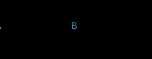

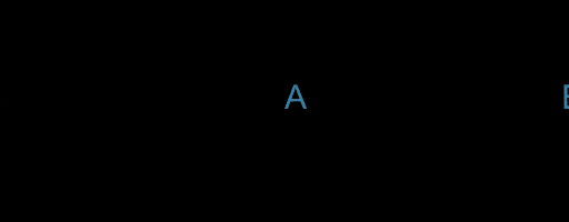

So for example, let's assume that we have two objects, A and B approaching each other, and at the moment they pass each other a flash of light is emitted. It doesn't matter whether A of B emits the flash. For an observer watching these two meeting, the light expands outward at c, while Both A and B move on from the point of emission. Like this.
However, If you are at rest with respect to A, this is what happens according to you
The light expands outward from A after B passes by and B chases after the left edge of the expanding light
If you were at rest with respect to B, then this is what happens
Now B remains at the center of the flash, while A chases after the right edge of the flash.
Thus is is more appropriate to say that the speed of light is invariant rather than absolute (Absolute implies that there is one single frame of reference which everyone agrees is the one that the speed of light is constant with respect to.)
