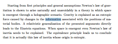

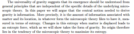

These are two snapshots, one from the abstract and the other from the introduction.
M. next said:
Why did Verlinde in his paper suggest that information is a central concept in the emergence of gravity? I mean why information and not something else?
I believe the inspiration for it comes from 2 things. Firstly, it is of interest to interpret physical phenomena in terms of information in keeping with the Holographic Principle. Secondly, the equations of gravity have similarities with the equations of thermodynamics.
