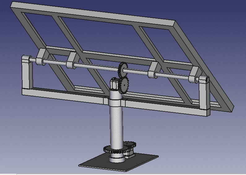

If I'm to choose a motor to suit a vertical load (torque)-see the attached picture for more illustration-. What is the criteria should i follow?
After i have done the math for the weight of the object to be rotated, the torque to rotate the load is to be horizontal, and i only have the weight -which is vertical-.

Here is the application to be implemented. It is a solar tracker, and i need to choose the proper motors for it, and still confused how the vertical load will affect motor's torque- I'm talking about the vertical-shaft motor.
And as our friend @Baluncore here said,
The weight of the shaft and rotating load will be carried on a thrust bearing.

Your diagram shows a gearwheel halfway along the horizontal shaft where maximum deflection will occur. That needs to be redesigned with the gear and motor mounted at the end of the shaft where there is a solid mount available for the motor and the driven gear.
When two gears are meshed, with a tooth force, there is a reaction due to the 20° tooth face angle that forces the two gear wheels apart. Meshed gears push shafts apart. Sprockets with a roller chain, or stepped belt, pull the shafts together.
Maybe you should be using roller chain rather than meshed gear wheels.
This also has environmental implications. Sunlight damages plastic and paint. Wind blows dust into gaps, damaging bearings and lubrication. Rain, salt and moisture cause rusting.

Solar trackers run at very low speed, so you can ignore acceleration forces. Wind loads on the panels are orders of magnitude greater than friction loads, assuming halfway reasonable bearings. Therefore, you can design for just the maximum wind load and ignore other loads. The design wind load is the worst case wind from the worst case direction with the panels in the worst orientation. Wind exerts a torque on the panels because the center of pressure is not the center of the panel when the wind is not perpendicular to the panel.
You need to find or specify the maximum wind velocity and the most vertical angle that the panel could be oriented. Then calculate the torque about the vertical axis.

It would be good to enclose the gear/chain mechanisms to keep them cleaner, and plan on a regular periodic maintenance (PM) schedule like once a year to clean and lube them.
This can be solved by supporting the horizontal shaft by equally-distant vertical pillars- using journal bearings, of course.

Should this be done also with the horizontal shaft, because i think this will be a bit complex in our case. And if it is possible to make an edit on this design, what would you suggest considering the horizontal shaft?

Where do I start.
Re: The drawing in post #16. The top part of the assembly, the tilting frame.
The tilted frame appears to be made from tubular material, so will be rigid = torque tube.
There is no advantage in having the long horizontal round shaft.
There is no advantage in having isolated supports on the long flexible shaft.
If there were three bearings, then you could use 3 short pins or bolts. That would make assembly and maintenance much easier since you do not have to thread the long pin through all the eyes.
The tilting frame has a wide middle bay. Add a tubular bay divider in the middle. Space the bays equally.
Narrow the U fork so the ends are inside, not outside, the tilting frame.
The U does not need to be so wide. Bring the ends into be inside the bay separators.
Put a support bearing in the middle above the post. That will bear part of the weight of the tilting frame on the middle divider. Put simple pin bearings at the ends.
Mount the tilt drive at one of the three pin bearings, sheltered below the tilting frame.

The bull-gear, or chain sector size, and the location of the drive mechanism are important. The drive mechanism connects, constrains and bridges between the two sides of an axis.
The azimuth bearing could be at the base as shown in #16, part way up, or at the top of a fixed post. The maximum wind moment will be at the base of the post. I would lift the AZ bearing and actuator to the top of the post, close to the similar elevation mechanism. Not only are wind induced moments on the azimuth bearing reduced, but the mechanism is then also clear of the ground, children and animals. It can bring all the mechanisms into one housing.
Once the placement of the azimuth bearing has been decided, the FBD can be drawn.
