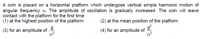

Text problem: a coin is placed on a horizontal platform undergoing vertical simple harmonic motion with angular frequency ω, amplitude gradually increased; options: (1) highest position, (2) mean position, (3) amplitude g/ω², (4) amplitude g²/ω².
Suppose mass of platform is ##M_1## and that of coin is ##M_2## . The normal force between them is N .
EOM for platform (mass M1) = ##-kx+M_{1}g+N = M_{1}\ddot{x}##
EOM for coin(mass M2) = ##M_{2}g-N = M_{1}\ddot{x}##
This gives , ## N = \frac{kxM_2}{M_1+M_2} ## . The normal force vanishes when x= 0 ,i.e when the spring acquires its natural length .
I feel there is something wrong with my work . I would be grateful if somebody could help me with the problem.

More than one option right?
You start,! you think Option A is right? or B?
Also i think there might be a simpler way to solve you're problem apart from your posted method, just use ##a = \omega^2 x## and a=g if you get the first part (option A or B ) you'll know what is x.
Hi Tanya. You really don't have to include the mass of the platform in the analysis. It is forcing the coin to move in the manner it tells the coin to move. So, the motion of the coin is just
y = Asinωt
From this, what is the acceleration of the coin? What does the force balance on the coin give you? Look at the force balance at 4 times through the period.

The platform is made to perform SHM with angular frequency ω and with increasing amplitude. That means its position is Asin(ωt), a known function of time, with A slowly increasing with time.
You meant ##M_{2}g-N = M_{2}\ddot{x}## did you not?
That is correct if you choose "down" positive. But the platform can exert only upward normal force, so it must be positive. The coin stays on the platform and does the same motion as the platform. x for the coim is the same as x for the platform. The acceleration of the platform is ##\ddot x = -\omega^2 x##, so
##N =M_{2}g- M_{2}\ddot{x}=M_{2}(g+\omega^2 x)## . At the top, x = -A, negative. The coin loses contact with the platform if the normal force needed to move it together with the platform should be negative. What does it mean for the amplitude?
