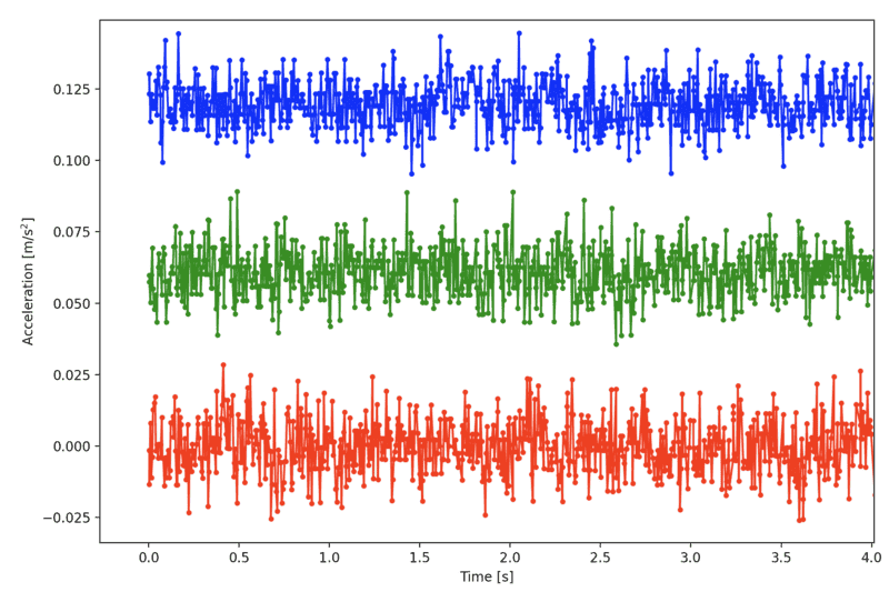

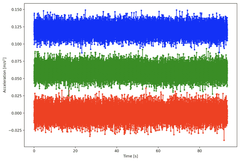

Hello! I am trying to build an optical cavity and I am having some issues with vibrations. I attached below a plot of the acceleration in x, y and z as a function of time, when the accelerometer is placed on the optical plate (x is red, y is green and z is blue; I shifted them upwards for visualization purposes and the second image is just a zoomed in version of the first).
In my setup I have a plate made of aluminum (9.5 x 200 x 500 mm) that is attached to an optical table (not floated) at the 4 corners and on this plate I have the mirrors building the cavity. I initially thought that the vibrations are due to just motion in the room (or even on the table), but I added some sorbothane today and I saw no change in the vibrations.
I assume that the issue is of a different nature. I was thinking it might be the plate itself vibrating, but shouldn't in that case the vibrations be at the resonant modes of the table? My spectrum looks quite like a mess (the data is for some reason not taken at equal intervals, but I did a linear interpolation and took the FFT of that, and I saw no clear peak). I also see the effect of this vibration on the osciloscope when scanning the laser frequency, the peaks moving left and right on the scale of a second or so.
Does anyone know what can cause this kind of vibrations or how can I further investigate the cause? Thank you!

Did you make sure that the accelerometer signal you see is above the noise floor? What is the noise floor for this accelerometer? It should be in the datasheet / manual somewhere.
For the issue of non-uniform sampling, try a Lomb-Scargle periodogram, aka least squares spectral analysis. Here's an implementation in Scipy and here's one in Matlab. I'm not 100% positive it's the right thing to do (since you signal isn't truly periodic), but it might be worth trying.
I am not sure about sorbothane. Someone suggested me to try using it, but I have no experience with it myself. I will check the noise floor for it. Actually (@berkeman) I used my phone accelerometer to measure this, hence why the issues with the data (I am waiting for a better one to arrive but it will take a bit, so I wanted to get an idea of what is going one before). The main issue (as mentioned in my previous post, too) is that the peaks are oscillating left and right, so something is changing in time. Might not be the cavity itself, tho.

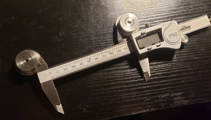

This is going to be a lot easier to show you how to do than to explain. Funnily enough, I happen to have a couple of 1" posts on hand so I took a picture of how you'd do the measurement:
This is going to be the most convenient way for you to take measurements of the distance between mirrors with a typical 12" caliper set.
The next piece of information you need is the distance between the center of the mounting post and the front face of the mirror. I can tell you by looking at the cad drawing from the mirror mount you linked that the distance from the mounting hole (the center axis of the post underneath) to the mirror face is 0.5inch. The issue is that the mirrors are at an angle to the measurements you are taking, so you need to do some ray optics to get the angle of all the mirrors. If you have those angles, then you can do some trigonometry and find the exact offset between the measurement I showed above (distance between insides of the mounting posts) and the true distance between mirrors.

Thanks a lot for this! I actually have the math of it ready already (I used it when designing the holes for the mounts), so I should be able to calculate ##d_3##. One thing I am not sure about is the angle of the mirrors. In theory I know what it should be. But most probably that is different in practice (i don't know by how much). Do you know how I can measure that?
