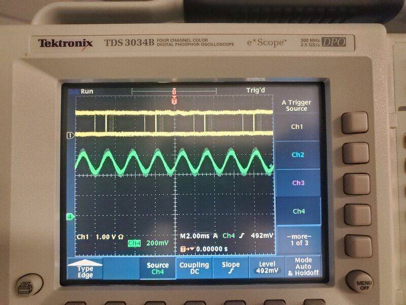

@Twigg I spent some more time on this cavity and I am still having issues but I tried a few things. After I added the 50 Ohm resistance the peaks are now about as narrow as I would expect from calculations (around 50 kHz - the laser has a linewidth of 5 kHz). Also they seem to not move a lot left and right. However the amplitude of the peaks during ramping changes a lot (by a factor or 2 even more) over very short periods of time (below one second). I looked at the beam profile outside of the cavity, and it seems to be TEM00 without any other modes present (at least not intense enough for my camera). Also the beam diameter seems to be about the size I would expect from calculations. However the intensity of the spot of the camera changes a lot (corresponding to the change in the peaks height I assume). All this happened when I was scanning the laser frequency, while the cavity was free (the cavity is not locked). Today I added a piezo to one of the mirrors and I applied the ramp to the piezo while the laser frequency didn't change (the laser frequency it's supposed to be super stable - I would need to check the exact numbers). However, the result was basically the same as before. Everything is as predicted by calculations, but the peaks heights change a lot. I expected that using a piezo would at least reduce the issue. Also, if it is due to vibrations, I am not sure I understand why the height of the peaks changes so much. If the length of the cavity changes due to vibrations, I would imagine that the location of the peaks to change, not the height. Do you have any idea of what is going on? Or at least a way to try to figure out what is going on? Thank you!
Just to clarify, you are seeing a variation in the peak height of the power transmitted as seen on a photodiode (or camera), from one frequency scan to the next? What frequency are you scanning the laser at?
The camera is not a great tool for this, because it is updating with some frame rate which may alias with the frequency at which you scan the laser. However, if you see the effect on a photodiode, then you know it's real.
Vibrations sounds likely. You are right that vibrations of the cavity mirrors should cause both peak height fluctuations and shifts of the resonance. However, you could also have vibrations upstream of the cavity that cause fluctuations in the coupling of the incident beam. You could verify this by putting your camera (or even better, a quadrant photodiode) in front of the cavity (temporarily, just to see how much the beam position fluctuates).
Another possibility is absorption of the enhanced cavity field by the air. (Check the absorption of H2O at 1064nm.) When you scan the laser with a positive sloping ramp, is the linewidth any different than for a negative sloping ramp? That effect (thermal self-locking) is the signature of absorption in a cavity. This asymmetry is more prominent at higher power and the two linewidths should become more equal at low power.
I am certainly no expert, so take my observation with a grain of salt, but I suspect that the variation of amplitude are caused by back scattering in the ring cavity. Unfortunately, back scatter is unavoidable due to imperfections in the cavity mirrors.
@Twigg @Fred Wright thank you for your replies. Just to clarify, I am using a photodiode to see the power transmitted (peaks) and a camera to see the spatial modes. So I decided to put my diode before the cavity and I noticed that I have a weird signal at around 500 Hz and it seems like it is not from the laser. When I blocked the laser, the oscillation was still there (see attached picture). Do you know what that can be from?
Maybe try using a different power supply with that photodiode? It could be a ripple on the bias voltage caused by a faulty power supply.

So I tried a different diode, with a smaller area, and I see the same effect, just reduced magnitude. Then I realized that if I turn off the light in my lab, the effect is significantly reduced. So it seems to be from that, although not totally sure why. But I assume that wouldn't affect the lock. Could it just be that I am simply not yet well aligned? Maybe I am in a sort of local maxima where I do get some amplification, but it is not the ideal alignment point.
Oh right. Your overhead LED lights are probably being dimmed by pulse width modulation at a switching speed of 500Hz, causing them to flicker imperceptibly.
If you put the photodiode back on the cavity transmission and if you turn off the lights, how is the peak amplitude? More stable?

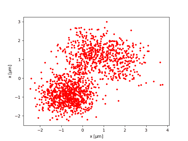

I am attaching below a plot of the center of the input beam (with a diameter of about 1 mm) taken over a period of 2 minutes. It seems like the center changes by about 1-2 microns. The center is obtained by fitting a 2D gaussian to the beam profile, however due to some internal interference on the CCD camera, there is some interference pattern on top of that, so I am not even 100% sure if this change in the center is real or just some fitting issues.
In that case, its definitely not caused by fluctuations in input beam pointing.
If it is backscatter, as @Fred Wright suggested, then it would be a significant amount of light in the counterpropagating mode, comparable to what you see in transmission (since you're able to see a factor of 2 change).
You can look for backscatter with a 50:50 nonpolarizining beamsplitter placed in front of the cavity. Half of the backscattered light should come out on one side of the beamsplitter, on the opposite side that the incident light gets reflected. Sorry I know that's not terribly clear without a diagram.
