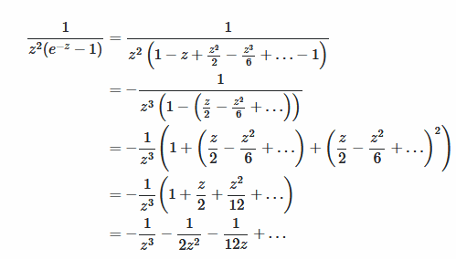

Apparently, yes, according to https://math.stackexchange.com/questions/728590/calculation-of-a-residue: (being very slow with LaTex, I will take the coward's way out and just paste the derivation)
although I am not sure whether there is a shorter way to go from the third line to the fourth line besides laboriously calculating the Cauchy product each time.
So this answers my main question in [1]. If I am lucky someone will also turn their attention to [2].
