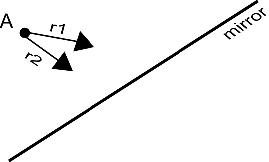

I will illustrate this with a question:
The figure shows a light source A, from
an ordinary light bulb, that
transmits rays in all directions. two
of those light rays (r1 and r2) are drawn
You also see a mirror. The (specular)
front you will find on the side of
the light source.
The drawing is a top view of
the situation, otherwise
said: we concentrate on
the directions in the plane in which we draw
and forget the space in which we
ourselves.
-The rebounding rays are portions of whole lines. Draw those entire lines, so
even the pieces on the back of the mirror and mark the point of intersection.-That marked point of intersection has a special position with respect to the light source!
What position is that? Show the validity of your claim.

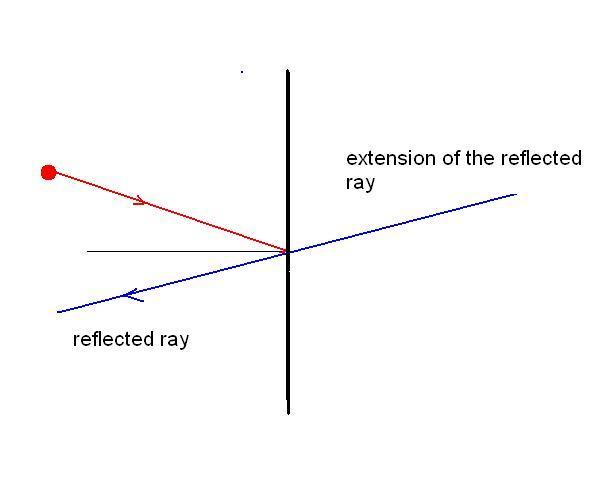

You know the law of reflection, draw some reflected rays, and extend the lines to the other side of the mirror. What do you see?
ehild
It feels a bit strange intuitively if you see that the blue line goes through the mirror, instead of bouncing off the mirror?
And what does the 'point of intersection' actually intersect? The mirror, the red line or what?
It bounces back from the mirror. The arrows show how the real light ray travels. But its line is extended behind the mirror.
If you take a second ray emerging from the source, and reflected from the mirror, the extension of that reflected ray intersects the extension of the first reflected ray. The extensions of all reflected rays intersect at a single point: That is the mirror image of the source point.
You see the object in the direction from where the light ray arrives to your eyes. It is a print-in knowledge in your brain that the light travels along straight lines. Your mind extends the light rays arriving to your eyes and "see" the object at the intersection of the extended lines.
