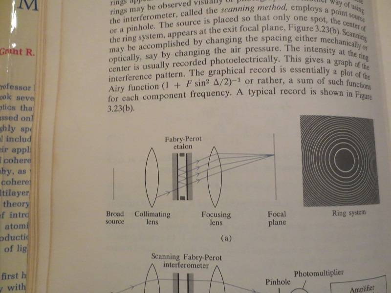

This brings up memories of the Modern Optics class I had while getting my Engineering Physics BS. Her are some photos of the Text, I still have, and a couple photos about the Fabry-Perot interferometer:

Textbook page diagram (a) of a Fabry-Perot etalon setup: broad source, collimating lens, Fabry-Perot etalon, focusing lens, and focal plane, with a ring system pattern shown at right.

The OP should do a google search for the prices of FP etalons. That would be the best way to estimate just how hard they are to make without full lab facilities.
