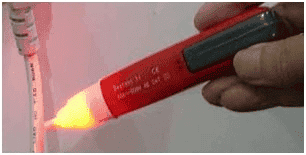

Sounds like the non-contact AC voltage detectors that electricians already use...
https://engineering.electrical-equi...tion/non-contact-ac-voltage-testers-work.html
Hand holding a red non-contact voltage tester pen with its tip glowing orange-red against a white wall near a cable.

In the link provided by @berkeman, it says the following. Pay attention especially in the parts I marked in red.
Magnetic induction testers
The inductive coupled tester comprises of a sensor winding at the tip. When this winding is placed within the electromagnetic field, a voltage is induced in the winding and used to light or sound an alarm though a circuit within the tester.
A current will only creates an electromagnetic field if it is flowing. And since this tester works by detecting the magnetic field around conductors, it will only work in a if the conductor is part of a complete where current is flowing. As such, it will not indicate anything when there is an energized wire, but the circuit is not complete.
Capacitive sensor element
The tester uses capacitor coupling to detect an electric field and is capable of detecting energized conductors whether in a complete circuit or not.
For the tester to work, the person must touch the metal part of the tester so as to provide a ground reference and allow the stray capacitance from the live conductor to flow to the ground. Placing the tester near a live conductor forms a capacitive voltage divider network. This comprises of the parasitic capacitance between the sensor tip and the live conductor, and the capacitance between the sensor and the ground through the body of the user.
Once the current flows to the ground, the tester will indicate the presence of the voltage through the light or sound.
