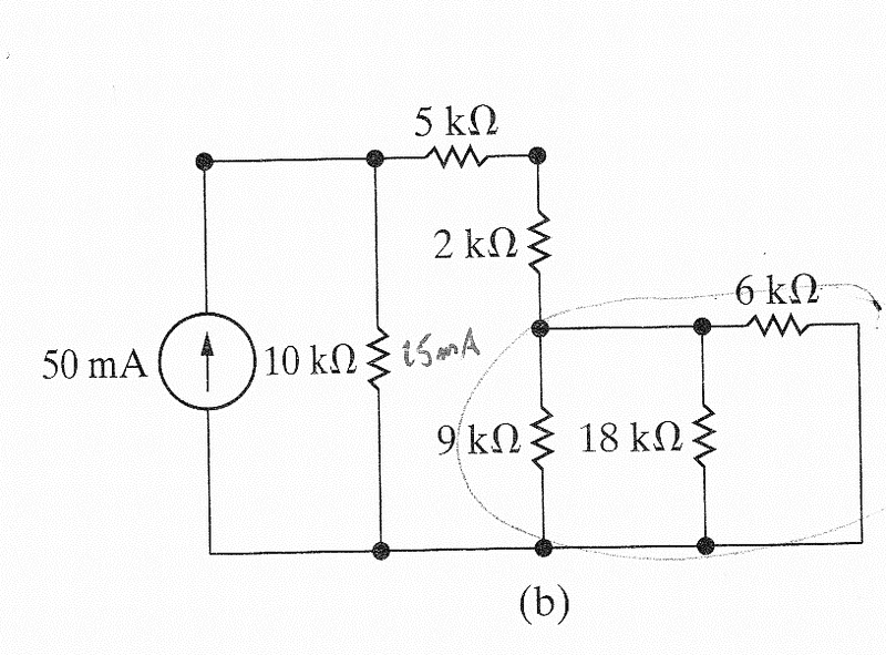

see attached for circuit
from your result from part b, use voltage division to find the voltage drop across the 2k ohm resistor. my result from b was 250V
part b question was voltage drop across 10K resistor
R_T=5k ohms
v=V_2k/V_T = 100v but the answer is 50V?

What does R_T stand for?
total of the other resistors
You must have calculated RT wrong.
I get the book answer.
Don't forget the 5kΩ resistor.
can you tell me how please, I got 5k for Rt
The 6kΩ, 18kΩ, and 9kΩ resistors are all in parallel with each other.
That combination is in series with the 5 kΩ and 2 kΩ resistors.
The above is what I would call RT, judging by the way you used RT.
