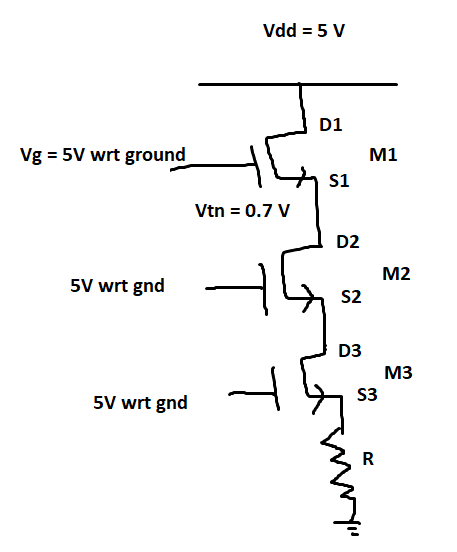

When three n type mosfets are stacked, what will be potential across V(ds)3 where:
DS1 is drain source of 1st mosfet. Drain is connected to Vdd. Source is connected to drain of second mosfet. Source of second mosfet is connected to third mosfet. Source of third mosfet is connected to resistance that is grounded
Vdd --> Vd1s1 --> Vd2s2 --> Vd3s3 --> R --> Ground
Mosfet turns on when Vgs > Vtn and Vds > (Vgs - Vtn)
Here's the circuut:
Vtn is 0.7 V. So Vs1 (wrt ground) cannot be more than 4.3 V else M1 won't turn on.
Likewise Vs2 and Vs3 (wrt ground) cannot be more than 4.3 V else M2 won't turn on.
So Vs3 = 4.3 V. Even voltage across final resistance is 4.3 V
Assume there's no drop across Mosfet.
But I'm not sure. Will the drop of 0.7 be accumulated. Like Vs3 would be Vdd - 3 times Vtn?
Will Vs3 (wrt ground) be 4.3 V or (5-3 times 0.7) = 2.9 V
The 2 scenarios for this question are:
1) All mosfets are in saturation mode
2) The mosfets can be in linear mode

Why are all 3 gate voltages equal in this scenario?

How can you have different situations with the same bias condition?

First, let's assume R >> Rds(on). Rds(on) is the device resistance (drain to source) when it's saturated. This means we don't have to worry about resistive dividers and how much current is flowing.
Second, what you are calling Vtn everyone else calls Vgs(th) (the Gate Source Threshold Voltage). OK, it's somewhat arbitrary what you call things. But... EVERYONE who works with MOSFETs uses Vgs(th), get used to it. Also be suspicious of people who choose a different name, they probably haven't read many MOSFET datasheets, which means they haven't worked in this field much.
OK, now...
Mosfet turns on when Vgs > Vtn ---- Yes.
Mosfet turns on when Vds > (Vgs - Vtn) ---- No. N-MOSFETS can be on even when Vds < 0. This isn't just the built in body diode. They can conduct in either polarity through the channel if Vgs > Vgs(th). This is commonly used in synchronous rectifier circuits to reduce losses since the voltage drop across the channel is (usually) lower than the voltage across the body diode.
Each N-MOSFET is on if Vgs > Vgs(th), it's really that simple. When the MOSFET is on, the drain is essentially connected to the source with a channel resistance of Rds(on), a small value in this case.
So, you have a set of rules (one, really) about when a MOSFET is on. This seems pretty easy to apply in this circuit. Maybe you can think about this and explain again about what is confusing you?

Ok.. So if Vgs(th) > 0 and if Vds < 0, then also the Mosfet is On, however current direction is reversed. Makes sense.
But assuming that Vgs(th) >0 and all Mosfets are in saturation mode with current flowing from drain to source,
I'm not able to figure out the drop across M1, M2, and M3
The voltage Vd2(wrt ground) and Vd3(wrt ground).
In case of Si Diodes, we take voltage drop as 0.7 and keep on subtracting in series.
Is that the same case here?

No, the situations are different. The gate voltages are just sufficient enough to turn on the mosfet as in. Vgs > threshold voltage.
I have no idea how this circuit will work. Electrical engineering is easy with RLC but electronics makes it difficult when diodes and fets come in.

No, not for NMOS. A MOSFET in saturation acts just like a resistor.
