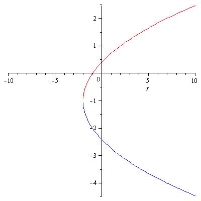

It is actually two square roots, pasted together though. You can see this by solving the equation for y, resulting in your usual "y = f(x)" graph. For general a, b, c:
[tex]y = \frac{-b \pm \sqrt{b^2 - 4ac + 4ax} }{2a}[/tex]
(Two equations, one for + and one for -!)
If you graph these, we get (using a = 1, b = 2, c = -1 for example):
Graph of a sideways parabola x-axis from -10 to 10 and y-axis from -4 to 2, drawn as a red upper branch and a blue lower branch meeting near x = -2, y = -1.
(The two don't meet in the middle exactly because Maple has trouble graphic them there.)If you really can't figure out the shape of a curve, why not simply try to draw a few easy points on paper? Like (0,0) or (0,1), (1,0) etc... You will most likely recognize a familiar shape from that, and you can then go on and analyze the curve equation further.
