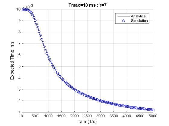

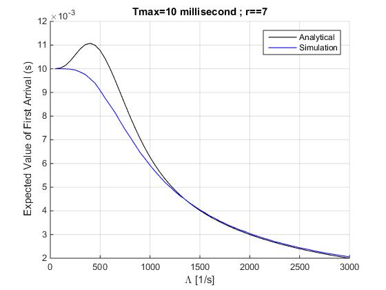

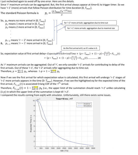

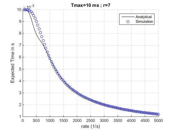

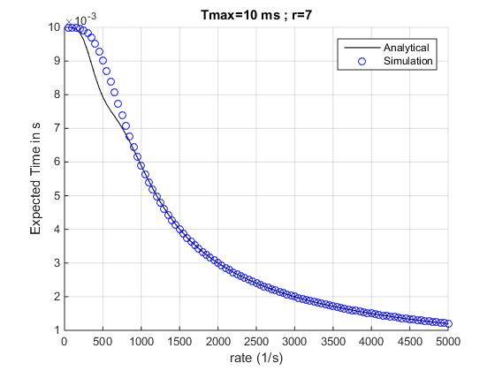

Mehmood_Yasir said:

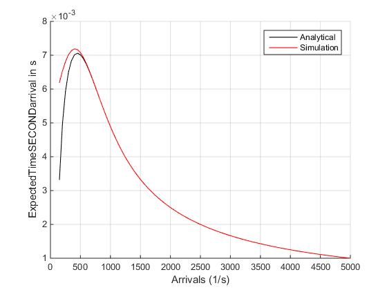

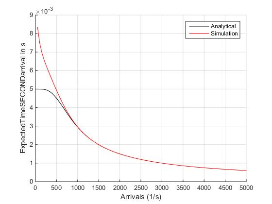

We represented expectation value of the waiting time of the first arrival as Tmax*(po+p1+p2+..+p_r-2)+(1- sum((po+p1+p2+..+p_r-2)))*(r-1/lamda). The results I showed in the graph you can see show some mis-tmatch for lower lambda, i.e., in the part of Tmax. Its means in the first portion of the formula related to Tmax, sum of all probabilities results more values compared to actual simulations results. As In simulations, sometime 1,2,3 or any number of arrivals < 'r-1' (excluding the first one) are multiplexed, however, the formula some how gives upper bound of the expectation values (i feel).
Now, I just removed the ##p_{r-2}## and kept the sum from ##p_{0}## to ##p_{r-3}## and Multiplied with Tmax, however, the second portion of the formula is kept same i.e., it considers the ##p_{r-2}## when calculating 1- sum(##p_{0}+p_{1}+p_{2}+p_{3}+...+p_{r-2})## * ##(r-1)/ \lambda## And surprisingly results fully match for all cases, for any Tmax, and for any 'r' ..But I could not get why deleting ##p_{r-2}## from the first part result this.
Here you can see the results.
The pictures are a great way to think about this. In particular https://www.physicsforums.com/attachments/112341/ is a very good picture.
Keep in mind that the actual analytical result is
##E[k_{ArrivalTime} \big | y \leq \tau]= \frac{k}{\lambda} \Big( F_{Y{_{k+1}(\tau)}}\Big)##, but so far as I can tell, in the first picture you are just using ##\frac{k}{\lambda}##. Put differently you are using the upper bound, not the exact analytical solution.
I just want to be sure that you realize that when I originally said:
## = ExpectedTimeUntilFirstArrival + p * T_{max} + (1-p)(ExpectedTimeUntilArrival_{r-1}| \tau < T_{max})##
we can now rewrite this as :
## = ExpectedTimeUntilFirstArrival + p * T_{max} + (1-p) \Big(\frac{k}{\lambda} \Big( F_{Y{_{k+1} (\tau)}}\Big)\Big)##
hence you'll see something that looks like a complement of a Poisson twice in the term ##(1-p) \Big(\frac{k}{\lambda} \Big( F_{Y{_{k+1}(\tau)}}\Big)\Big)##, first in the ##(1-p)## component, and second, something similar in ##\Big( F_{Y{_{k+1} (\tau)}}\Big)##
edit: it looks like your second picture *might* agree with your simulation as you seem to have done some additional cancellations / simplification related to the different complements. Even then, the agreement almost looks too good ;-)
Congratulations on getting an analytical solution! I think you can see from this example that queuing problems quickly get too hard to solve analytically except for the most idealistically simplified cases. Computer simulation is the only way to do complicated work in this area.
Hi. Good morning! A great help indeed by you. Yes, In the first picture where there are some mismatches, I computed the analytical results using ## = ExpectedTimeUntilFirstArrival + p * T_{max} + (1-p)(ExpectedTimeUntilArrival_{r-1}| \tau < T_{max})##, I considered ExpectedTimeUntilFirstArrival=0, p is summation from ##p_{0}+p_{1}+...+p_{r-2}##. So, the overall formula was ##p*T_{max} + (1-p)*((r-1)/\lambda)##. To be a bit clear, I used ##((r-1)/\lambda)## instead of ##r/\lambda## as in this case we will have have 'r-1'th as our last arrival neglecting the FIRST one. If i use ##r/\lambda##, the matched part of the first figure over the higher arrival rate also mistmatches with simulation by a value of##1/\lambda##.
You are right. If I consider your actual proposed expression
If I am not wrong, if the max. ##r## arrivals can be multiplexed, the above formula can be considered as,
## = ExpectedTimeUntilFirstArrival + p * T_{max} + (1-p) \Big(\frac{r-1}{\lambda} \Big( F_{Y{_{r} (\tau)}}\Big)\Big)##. Right?
I mean, I used, ## (1-p) \Big(\frac{r-1}{\lambda} \Big( F_{Y{_{r} (\tau)}}\Big)\Big)##, Then yes, you are right probability factor in the second part of the equation will appear twice. The expression will like, ## = p * T_{max} + (1-p)* (\frac{r-1}{\lambda} * (1-p)## as ExpectedTimeUntilFirstArrival=0; and ##\Big( F_{Y{_{r} (\tau)}}\Big)## is actually also ##(1-p)##. Also, I can check the results quickly.Let me share with you.

I have just computed the results using this expressions, ## = [ExpectedTimeUntilFirstArrival=0] + p * T_{max} + (1-p) \Big(\frac{r-1}{\lambda} \Big( F_{Y{_{r} (\tau)}}\Big)\Big)##, in which
##p= \Sigma_{k=0}^{r-2} p_{k}## , 1-p= 1-## \Sigma_{k=0}^{r-2} p_{k}## and ##\Big( F_{Y{_{r} (\tau)}}\Big) = 1-\Sigma_{k=0}^{r-2} p_{k}##
I got these results, a bit mismatch again for lower lambda, however, the analytical values decreased some

My gut tells me there is an indexing by one error in one of your terms. That is, I think it should be ##\Big( F_{Y{_{r} (\tau)}}\Big) = 1-\Sigma_{k=0}^{r-1} p_{k}##
But I'll have to take closer look after some sleep. In general, indexing errors are quite easy to come by in math and programming -- especially when you switch between something that zero indexes like python to a one based indexing like matlab!
One way or the other you're basically there.

OK Many Thanks. Yes, I can recheck again my terms if something off by one error.. Sure, you take sleep and I will update again. Thanks once again for this great help.
I just tried to solve this.., for calculating Erlang CDF for rth arrival. The upper limit go to 'r-1' instead of 'r-2'
Here is the explanation. Unfortunately, results don't match for lower lambda,

try this instead:
= [ExpectedTimeUntilFirstArrival=0] + p * T_{max} + \Big(\frac{r-1}{\lambda} \Big( F_{Y{_{r} (\tau)}}\Big)\Big)
notice that the (1-p) is gone. There is a subtle conditioning issue here. Technically the (1-p) was ok to have in the model to begin with but after choosing the specific way to represent ##ExpectedTimeUntilArrival_{r-1}| \tau < T_{max}## that I did, I should have recognized that I was in effect double counting (read: double using) the 1-p term.
Basically it's already in the erlang density. You can see this if you look at the definition of erlang as ##
f_{Y_k} \approx \delta^{-1} * \big(TotalProbabilityAtLeastKArrivals(y + \delta) - TotalProbabilityAtLeastKArrivals(y) \big)## for some small ##\delta > 0##. Note the approximation becomes exact in ##\lim_{\delta \to 0}##.

Hi. Yes, that worked perfectly. Eliminating (1-p) from the earlier formula gave a perfect match :) But honesty I would request you to give me some detailed understanding of this. I mean considering the aggregation process, I could understand as i.e., when we mean as (p*Tmax)+(1-p)*(r-1/lambda)*F_Yk(t). For this, 'p' somehow gives the probability of aggregation due to Tmax, and its counterpart 1-p can be considered as aggregation due to maximal arrival. But, in the new one, when we remove (1-p), we used F_Yk(t) which means we only considered one more probability in the summation, i.e., the upper limit of 1-summation() goes to 'r-1' for F_Yk(t) instead of 'r-1' of (1-p) terms.
Additionally, is it not mandatory the sum of all probabilities used to calculate expectation value should sum up to 1? If yes, then should I also consider to divide the whole expression with the sum of all used probabilities? I mean normalization? or its not needed?
Other than this, ManyManyThanks for this great cooperation. I would seek some further guidance from you as well.

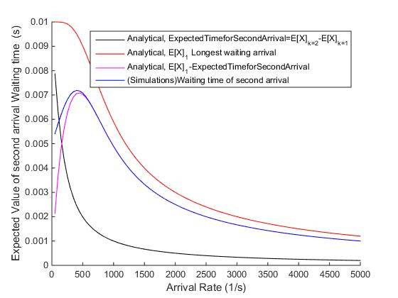

Based our previous knowledge, as the Expected longest waiting time of first arrival is ##EV = p * T_{max} + \frac{r-1}{\lambda} F_{Y_{r}}(T_{max})##, Also, we know that arrivals following a Poisson process appears with mean inter-arrival time of value ##\frac{1}{\lambda} ##, Therefore, the first arriving packet following Poisson process (it will be a 2nd arrival in total if we also consider the first arrival at time=0) will have expected mean time of ##EV_{FirstArrival}-\frac{1}{\lambda} ##, or in general ##EV_{i} = EV_{FirstArrival}-\frac{i}{\lambda} ## for ## i=2,3,...r ## However, I feel that it would again not work well under the low lambda cases, as the factor ##\frac{i}{\lambda} ## will be larger than ##EV_{FirstArrival}## particularly with low lambda cases, for higher lambda, it would work perfectly as the ##EV_{FirstArrival}## follows erlangian distribution as the clock does not play a vital role, and the Probability of (aggregation due to maximal arrival) is very high. I just implemented process in simulator for some analysis. For even lower lambda values, the expected time may be negative using this formula, which is not acceptable.
Similarly, for 'r' arrivals to be aggregated, the first arrival experiences longest waiting time, whereas the last one i.e., 'r_th' experiences the shortest waiting time. If we assume that the waiting time follows a uniform distribution within the interval 0 (shortest waiting time) and ##EV_{FirstArrival}## (longest waiting time). then, the mean waiting time can be given as the half of the longest waiting time i.e., ##EV_{FirstArrival}##. Again this will only fit when we will have 0 as the shortest waiting time, and this is only valid when aggregation is done by arrival of maximal arrivals before clock time out. But this is not the case for low arrival rate as aggregation is mainly done due to time out therefore the shortest waiting segment for low lambda will be greater than 0.

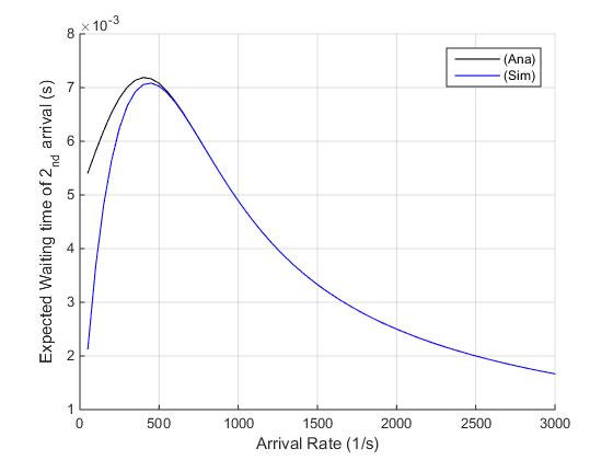

Hmmm, I like the pictures and convergence around 1000 or so. Can you restate what your question is? I didn't totally follow.
I am thinking your question may have a simple answer since you get a fresh start after each arrival -- including that first one that we've been ignoring except for the fact that it gets the clock going. Since you mention getting negative values at times, I'm thinking a 'simple' fix is in order. If not, at least be happy that you're asymptotically correct!

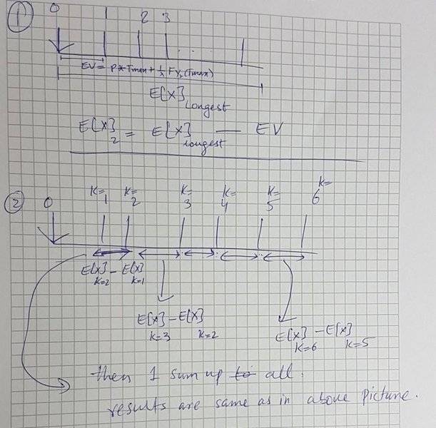

Hi! Yes, I can explain again. The first question is about subsequent arrival delays i.e., ##2_{nd}, 3_{rd}, ... r_{th}##.
As previously mentioned, I model e.g., the expected delay of 2nd arrival as ##EV_{FirstArrival}- \frac{1}{\lambda}##. I did this because we know the arrivals following Poisson process on average have inter-arrival time ##\frac{1}{\lambda}## However, this formula does not give precise results for expected delay values of 2nd arrival for low lambda. For higher lambda, it works well. How this discrepancy can be removed? any idea. ALSO, Yes, the negative values problem for very low lambda can be fixed asymptotically, but still the values with simulations does not match. Is it a right approach to model the expected value of the subsequent arrivals delays.
Secondly, the mean waiting time which I calculated above also has the same problem for low lambda. Actually I considered mean waiting time due to 'r' arrivals as the half of the ##\frac{EV_{FirstArrival}}{2}##. The reason why I used ##\frac{EV_{FirstArrival}}{2}## as mean waiting time due to 'r' arrivals is that the first arrival
experiences expected delay of ##EV_{FirstArrival}##, whereas the last experiences 0 delay. Thus, mean waiting time is ##\frac{EV_{FirstArrival}}{2}##. But infact, this is true for higher values of lambda like you saw in picture because first arrival experiences expected delay of ##EV_{FirstArrival}##, whereas the ##last## experiences 0 delay, However, in case of low lambda, first arrival yes off-course experiences expected delay of ##EV_{FirstArrival}##, but the last experiences delay not exactly equal to 0, but sometimes (>0) i.e., whenever aggregation will be done due to time out, and this is usual case when lambda is low. How to handle this case, i mean for calculating average waiting time.
The expected amount of time (given by the clock that starts after arrival one) associated with just arrival 2 is ##EV = p * T_{max} + \frac{2-1}{\lambda} F_{Y_{2}}(T_{max}) = p * T_{max} + \frac{1}{\lambda} F_{Y_{2}}(T_{max})## . For clarity, let's refer to the clock here as a grandfather clock.
Now let's say we also had a stopwatch that was to monitor this experiment from time zero and use it for keeping times, and you wanted to use it to measure the total expected time associated with the initial arrival (that gets the grandfather clock to start and nothing else), and the arrival that comes after, then that would be given by ##\frac{1}{\lambda}+ p * T_{max} + \frac{1}{\lambda} F_{Y_{2}}(T_{max})##, due to the fresh start that occurs after that initial arrival (and the linearity of expectations). Again, for this paragraph we are using the stopwatch, not the grandfather clock, for purposes of measuring total time.
Was this your question? I still can't really tell what you're trying to do on this most recent variation. Keep in mind that calculations and adjustments regarding what happens before the grandfather clock starts, should be easy.
Thanks. OK Let me put my question in the form of figure for a better understanding. Just give me some time.
