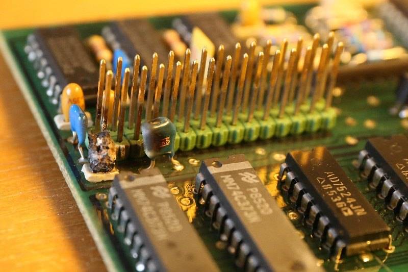

Good news. The repair was successful. The defect component revealed itself by a smoke signal.
Michael
