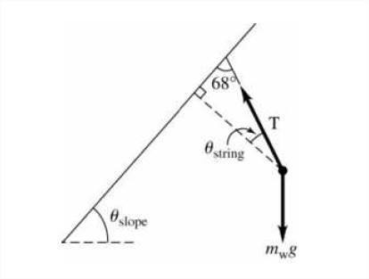

A steel washer is suspended inside an empty shipping crate from a light string attached to th top of the crate. The crate slides down a long ramp that is inclined at an angle of 37° above the horizontal. The crate has mass 180kg. You are sitting inside (with a flashlight); your mass is 55kg. As the crate is sliding down the ramp, you find the washer is at rest with respect to the crate hen the string makes an angle of 68° with the top of the crate. What is the oefficient of kinetic friction between the ramp and the crate?
ƩF=ma
fk=μn
Let mc = mass of crate
and my = mass of you
and m = mass of washer
ƩFcrate system = (mc + my)a = (mc + my)gsin(37) - μ(mc + my)cos(37)
Canceling out the combined mass and solving for μ gives:
μ = [gsin(37) - a]/[gcos(37)]
Apparently...
Let T = tension in string
ƩFy-washer = ma1 = Tsin(22) -mgsin(37)
and
ƩFx-washer = ma2 = Tcos(22) -mgcos(37)
And a2 = 0 allowing for these two equations to be rearranged and then divided by each other giving...
tan(22) = [gsin(37) - a]/[gcos(37)]
My actual question:
Where are the ƩFwasher equations coming from? I have the attached picture to help, but I still don't understand.
  • Free-body diagram of a washer hanging from a string on a tilted slope, showing tension T along the string, weight m_w g downward, the string angle theta_string, and the 68 degree angle to the slope edge, with theta_slope marked at the bottom.
Free body diagram for the washer.
So you didn't derive the equations yourself then?
You can also look at it from the POV of you - if the crate were stationary on the slope, what angle would the washer make to the ceiling?
