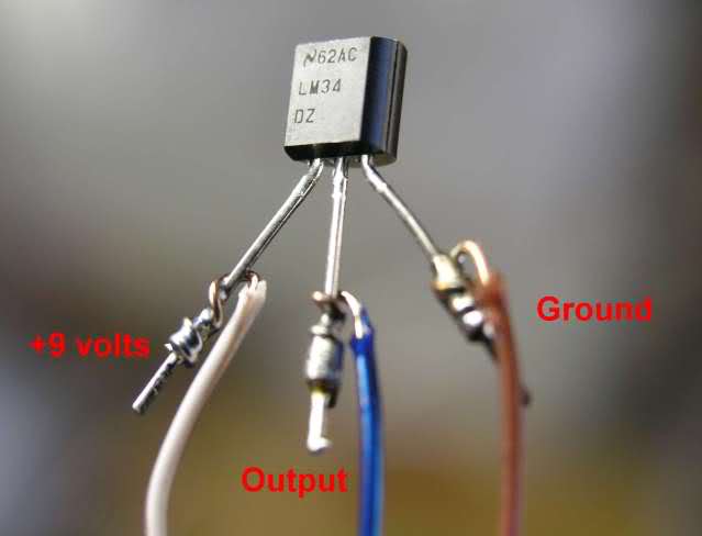

Hello all,
I've just completed a home made digital thermometer via:
http://sci-toys.com/scitoys/scitoys/computers/thermometer/thermometer.html
My problem is that I need the LM35 temp. sensor circuit to be water tight as it will be completely submerged in PROPANOL.
My initial idea was to coat the leads in clear nail polish, isolating the exposed leads coming from the sensor. But since it will be submerged in isopropanol (which is a pretty good solvent), I was worried that the nail polish would eventually wear off and short circuit the system.
Any suggesstions?
This is what needs to be water-sealed:
Thanks guys!
Propanol (or isopropanol) isn't a very good conductor, nor does it easily ionize, and you might be able to just submerge the sensor in it. Pure (as in distilled or deionized) water also isn't a very good conductor, but it tends to leach stuff from whatever it's kept in. I'd suggest hot gluing the sensor and then reflowing the hot glue (with a heatgun or blow dryer) such that you get a smooth, continuous, and water-tight finish, but I suspect the plasticizers may leach out (which will probably cause it to crack / discolor). Actually, this might be a problem with the plasticizers in the IC case, as well. Not sure what would happen if you just surrounded the sensor with (a thin layer of) silicone.
You could try any of the above in a small container of propanol for a few days (at the operating temperature) and see what happens.

i'd use epoxy. but if you encapsulate the whole thing, the thickness of the coating will slow the time response. also, there's an app note on that page.

One tip -- be sure to clean the circuit very well before potting it. If there are any contaminants (like solder resin) that get encapsulated with the circuit, you will get dendritic copper migration across surfaces that have to conductors with a bias across them. Like between the pins where they go into the TO-92 plastic package. Over time, this will lower the resistance between the pins, and eventually lead to a short.
You need to have a very clean process if you are going to encapsulate your electronics...

Small diameter heatshrink tube over each wire/lead with a larger diameter heatshrink over top may work. You may have to melt the one end to get a good seal. for example 3M FP-301 is rated down to -55 C and "excellent" solvent resistance.

Epoxy may have an issue bonding to the wire insulation, especially teflon insulation. Are the exposed leads submerged?
On second thought, for the heat shrink melting the end may not work well unless you get heat shrink tube that is specifically designed for that. As an alternative you could just place a small plug of plastic or metal that tubing could close around.
I wouldn't use an open flame, best would be hot air gun/hair dryer or else a soldering iron held near the tubing. If you use the sodering iron, shrink an area let the part cool, then shrink another area. The IC packaging is designed to withstand high temperatures for a few seconds during soldering so don't worry too much.

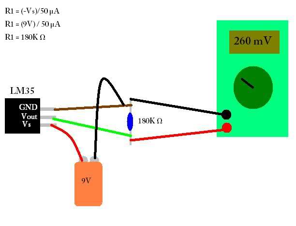

Ahhh! More problems!
So the good news is that after a day in the lab and testing out the probe, it is water tight and doesn't seem to degrade in the propanol in the time span that we use it.
Bad news is that this thing will NOT read any temp. below 0C!
I've been poring over the application notes for this little bugger, but my physics is a bit rusty so I wasn't able to pick up on everything.
This is what the circuit should look like for this sensor:
This (crude) diagram is what my setup looks like:
(Please excuse the lack of a proper circuit diagram! Have mercy on a biologist! :smile:)
Am I doing somethign wrong? I'm certain that's how it's suppose to be set up.
Any input would be greatly appreciated!

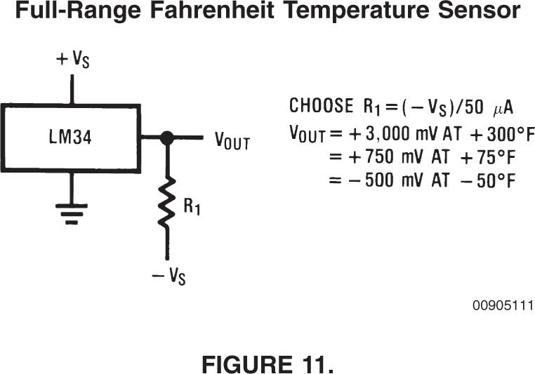

read page five of National's application note. you need both a positive(+Vs) and negative(-Vs) supply for that circuit. figure 10 is a workaround for full range and only one power supply.

yes, two 9V batteries connected as shown there, and the 9/0.000050=180k resistor

In trying to refit the system, one of the pins coming out of the sensor has snapped at the root. No soldering will save this tiny pin. I'll need to order a new one.
Hey Proton, I've drawn up this diagram for the new system. Does it look right in terms of figure 11 with the 2 supplies?

Don't you need the ground line connected to either the -ve terminal on the left battery or the +ve one on the right?
Remove one battery. Connect it between Vs and ground. The positive goes to Vs.
GND should be connected to the node where the batteries come together, plus to minus.
and they're not likely to discharge at the same rate, fwiw.
