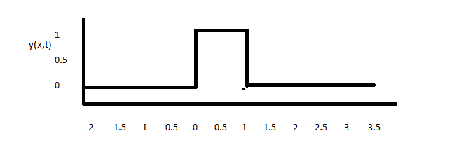

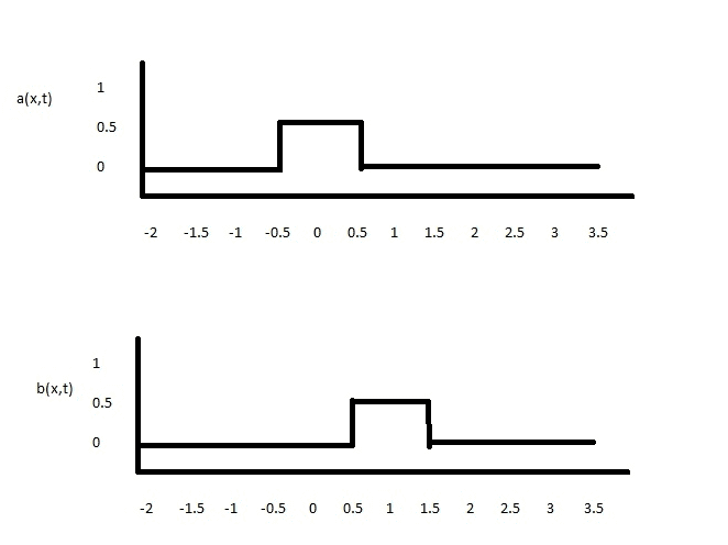

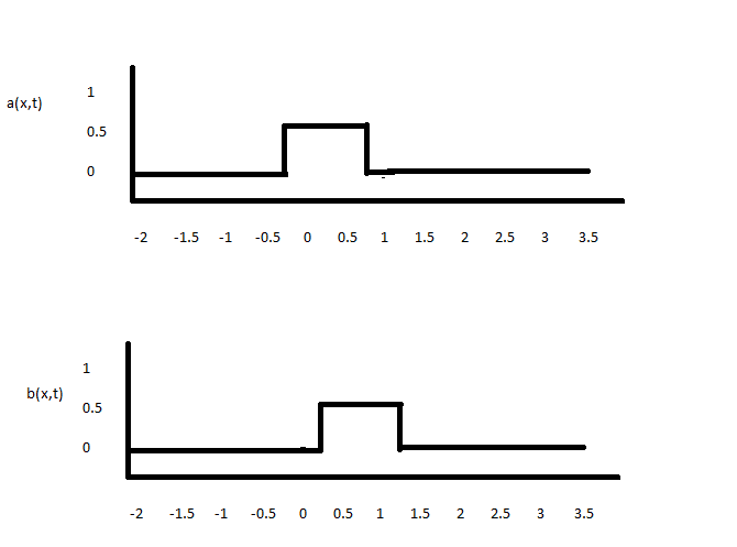

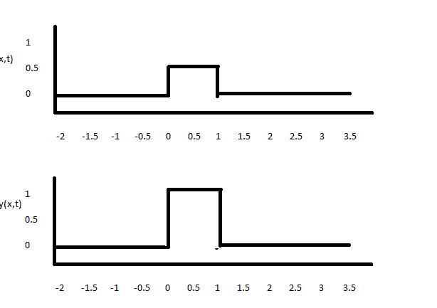

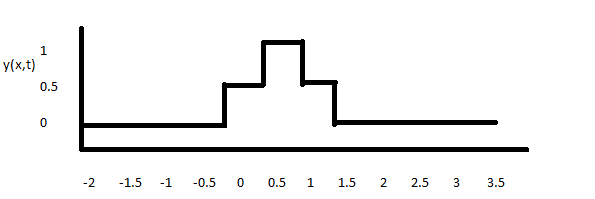

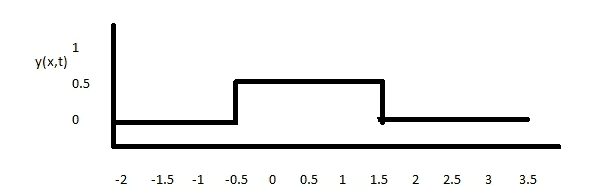

The question is to sketch for values of t = 0, t =0.25, t = 0.5, t=1 and t = 1.25 for the wave equation
Ytt = Yxx in the infinite domain with initial conditions
y(x,0) = f(x) =
\begin{cases}
1 & \text{if } 0 ≤ x ≤ 1 \\
& 0 (otherwise)
\end{cases}
Yt(x,0) = 0

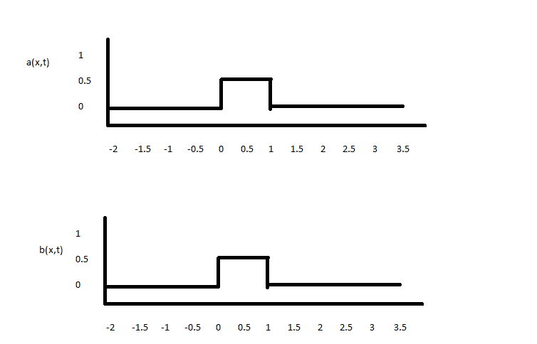

Y(x,t) = a(x,t) + b(x,t)
where a(x,t) = ## \frac {1} {2} \ ## f(x+t)
and b(x,t) = ## \frac {1} {2} \ ## f(x-t)
These are the sketches I obtained for those times and they are not to exactly measured to the points as I did them in paint. Can someone please tell me if the sketches are correct for this question!
for t =0
for t= 0.25

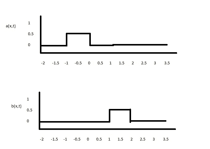

Attaching the remaining ones in the post below as you can't attach more than 6 in one post.

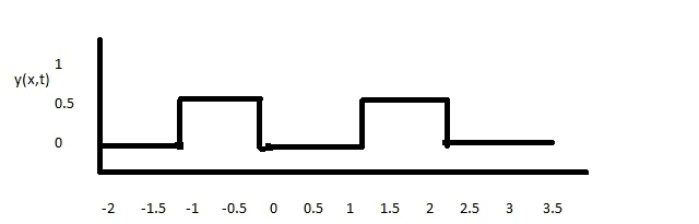

for t = 0.5 s
for t = 1 s

Look man can you be more clear? I don't understand what are you talking about. All I asked is if my sketches are correct or not, I am not asking you to do my homework for me.
Yes I can be more clear: I think what you did is excellent -- but you can't derive any rights from my statements.
My post #3 tries to express some reluctance about the "Is this correct" questions.

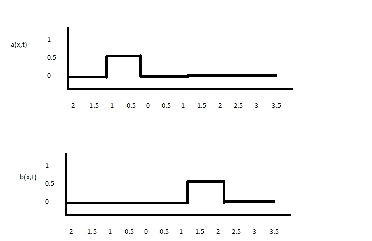

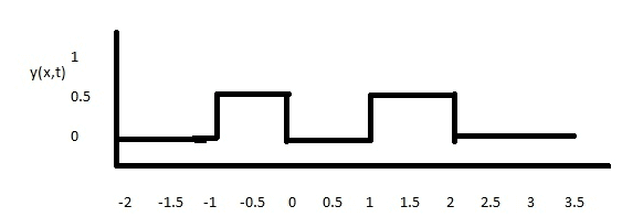

Cheers mate! I just realized I missed out t= 1.25 s for this question
Can you see the sketches for t = 1.25 s are excellent as well
As I said: you're so good you don't need assistance here :)
You do have me wondering what's the reason you ask for confirmation: you clearly understand everything that's going on, so why this possible doubt ?
