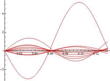

Code:
Nmax = 50;
L = Pi;
c = 1;
\[Lambda] = Table[Pi/L*(n + 1/2), {n, 1, Nmax}];
MyTime = Table[t, {t, 1, 10, 1}];
f[x_] = x;
A = Table[
   2/L*Integrate[f[x]*Sin[\[Lambda][[n]]*x], {x, 0, L}], {n, 1, Nmax}];
u[x_, t_] =
  Sum[Sin[x*\[Lambda][[n]]]*Cos[t*\[Lambda][[n]]], {n, 1, Nmax}];
Plot[u[x, MyTime], {x, 0, .135}, PlotStyle -> {Red}, PlotRange -> All,
  AspectRatio -> 3/4]

Plotting the function at 10 equal time steps in one period.
