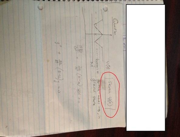

Given the potential, and energy of a particle at rest,
Sketch the wave function
The time invariant schroedinger equation
Time-independent Schrödinger equation: E Psi(r) = [-(hbar^2)/(2m) del^2 + V(r)] Psi(r)
I don't really know how to do this question
Handwritten notes on lined paper: a sketch of a potential well with energy E marked, labelled V(x), ground plane, and a circled Schrödinger equation d²ψ/dx² + (2m/ħ²)(E − V)ψ = 0.
Basically, I am given the potential, and energy of a particle. I need to sketch the wave function of the particle given these.
Do I just integrate twice then subtract something?
Nice exercise. You done the square well potential already (or was it in the main text) ?
E is probably a constant. But what about V? If you use Vo, it looks as if you consider it constant. in some places that's OK, but not everywhere.
