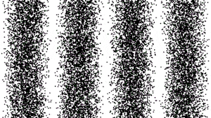

All I meant about quantum interference is that:
Once you measure the position of an electron, you get a point. And we you do that for a lot of electrons you get a probability distribution like the one below. The point I wanted to make was that electrons are particles (and are not spread in space) and the wavefunction is purely mathematical.
I also wanted to how does the photon picture correlate with the EM wave one?

You have a double-slit interference pattern that can be described by classical wave mechanics. Are you asking for the purely QM description?
There are already several threads about that on here.
The simplest description is that the slits act as a measurement of lateral position and by the uncertainty principle create an uncertainty in lateral momentum. This explains single slit diffraction. The Superposition of the two single slit wave functions causes the interference pattern.
In other words, uncertainty and probability replace classical wave diffraction.
Note that uncertainty by itself is not interference.
Likes Shreya
That was really helpful. Thank you! 😊
