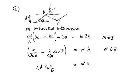

ok this is my lecturer's answer
i don't really understand what he's doing... hehex,

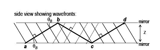

He seems to have only included one ray and you can't have a path difference between one thing. Unless there is light exiting along b cdashed. In which case it needs to be in phase with the light finally exiting out of the end.
He could be meaning a part-silvered mirror, where the portions of each exiting ray need to be in phase to get constructive interference in any particular direction. That's what his sums seem to imply. At other angles, the light will not be at a maximum coming out.
It's a bit like the Newton's rings calculation and similar things.

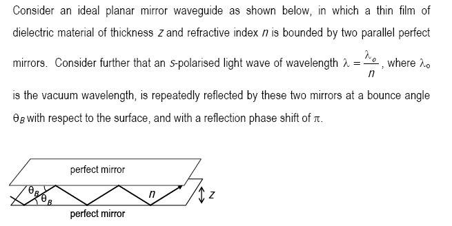

i think i will post the original question. maybe i didn't explain it well in the 1st
thread
does it make sense ?
I have a problem with it,
If, as he says, you need constructive interference for light to emerge and if the reflections are perfect and if the Energy has to go somewhere (which it must) then it would have to be reflected back the way it came. (It can't be absorbed anywhere within the waveguide because there is no loss mechanism).
The entrance to the guide would then appear as a perfect reflector at certain angles.
To get interference, you normally need two or more waves in the same place - as in the two slits experiment or when light passes through a thin film with partial reflections. I can't identify two paths here where light can actually interfere.
Apart from the impressive "[12marks]" at the bottom, the question looks wrong. You need to ask your guy where and how the interference takes place.
Else you can assume he is right and, looking at the geometry of the diagram and work out the value of angle where the waves on the extreme left would be in step with the waves parallel with them on the extreme right. The distance bc would need to be a whole number of wavelengths.
Thinking again about it, I suppose that you could imagine a whole bunch of 'rays' entering the waveguide gap over its whole width (the laser beam will have a finite width) and, because it is all coherent, then bits of one part of the beam could interfere with bits of another part of the beam unless the condition in the question is met. That may be what it's all about. Laser light does behave strangely because of its coherence - hence the speckles you see when it hits an object. Unlike a microwave waveguide, which is made as small as possible, an optical guide is pretty wide in terms of wavelength so what I know of normal waveguide didn't include this problem.
Go and do the calculation I suggest - you will get a range of possible angles which satisfy the condition: an n sin(theta) or an n cos(theta) should be in there somewhere! Good luck.

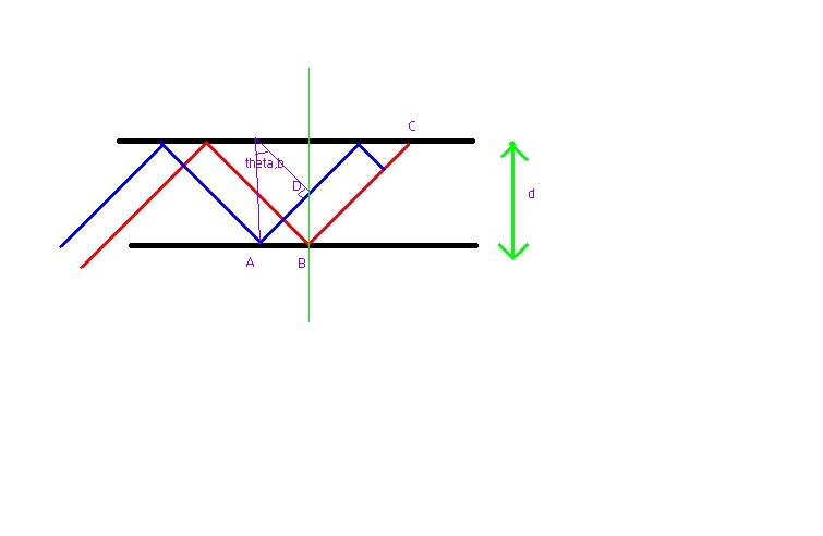

oh so bc is my path difference?
it looks kina profound to me
i only learned stuff like double slit and single slit where the path difference is kind of clear
but in this question, i don't understand why he even extends the bc to bc'.
so to start of, i presume the path difference is bc? so it has to be an integer of lamda for constructive interference?

The difference between the distance that two rays will travel down the guide. Your diag just shows one but they enter the guide over its full width. Any ray could destroy another unless the criterion I suggested is met. If the path difference is n lambda then there is no destruction.
There are more ways of killing a cat than drowning it. Just work out the angle as I said and you can get the answer.
ok, so dsin(theta) = m lamda.
so where did the 2 appear from?
AD is my path difference right?
does the 2 in my lecturer's answer come out due to the pi reflectance?
also how do i account for the 2 times of pi reflectance?
apparently my lecturer did account for it in his answer when he - 2pi. but is his answer some form of general solution or something ?
There are two reflections more for one ray than for the other - so 2pi is in there. But, as it is a whole cycle, it doesn't matter. What matters is the physical difference in path length for the two rays.
The path difference of interest corresponds to the difference in length between the distance to the first of the red reflections and the distance to the third of the blue reflections and, indeed, to the third of the red reflection, too.. If that is n lambda, then there won't be any destruction. The factor of two is due to the fact that the beam travels along two diagonals, each one being d sin theta . The waves / rays are totally in phase when they enter the guide and they will stay that way at the end if the total path for each is always n lambda. This only happens for the correct angles (there may be more than one solution if the guide is wide enough).
so the path difference is AD?
or did you mean the path difference is the horizontal distance between the 1st red reflection point to the 3rd blue reflection point?
oh so there will be a path difference for the 1st reflections and a path difference for the 2nd reflections so total is times 2?

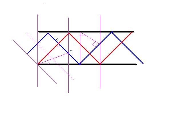

on further inspection, shouldn't my path difference be just XY?
i would appreciate if you could draw a diagram to show me where exactly is the path difference. i have an exam tomorrow. thanks
The path difference is the length of two of the zig zag paths. Some waves travel that much further than others. That is a path difference and it needs to be n lambda. There's really no more to be said.
